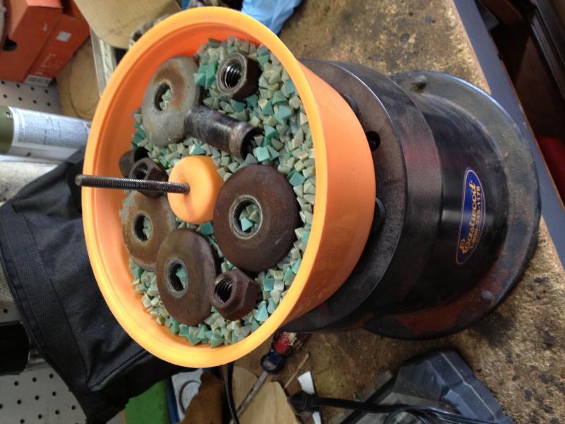

OK, so limited time this weekend, but I did set off to paint a bunch of parts. I also broke out my old Eastwood small parts cleaner. I'll tell you, the thing works like magic (and no, I have ZERO financial interest in Eastwood).

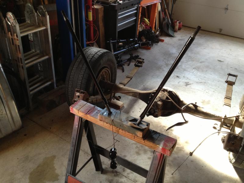

The painted strut rods and idler arm. LOL, if I don't get the car back together, I can always use these as rabbit ears for the TV! :icon_fU:

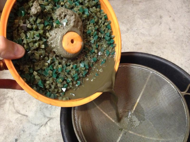

Photo got rotated when it uploaded, but I think you get the idea. Throw your crappy, rusty small parts in this with some water and let it run for a day...
Pour off the dirty water and dig out the parts...

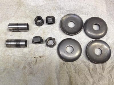

...And they look like this. If you want them polished, there is another bin (not shown here) that uses a dry red media to polish them up really nice. In this case, these are suspension parts destined for black paint, so no reason to do that...

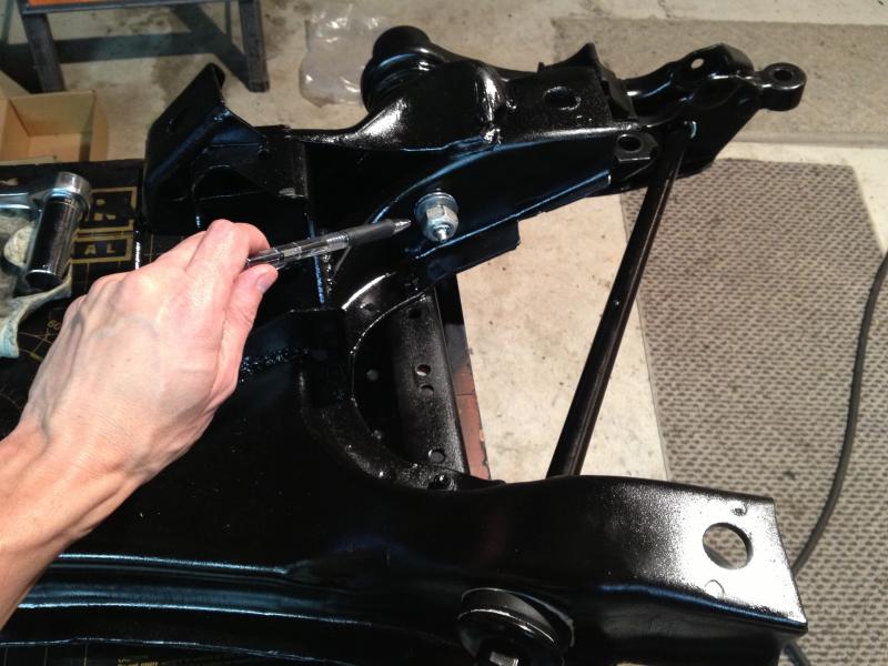

So I am making progress, but need some help. I got the small parts painted, and I am now finally installing everything. I had trouble with the control arm pivot shafts. As I try to tighten the nut, the shaft rotates in the control arm. I made sure to grease it well when I installed it, and now that seems to be causing me problems.
Any suggestions on how to tighten the pivot arm?

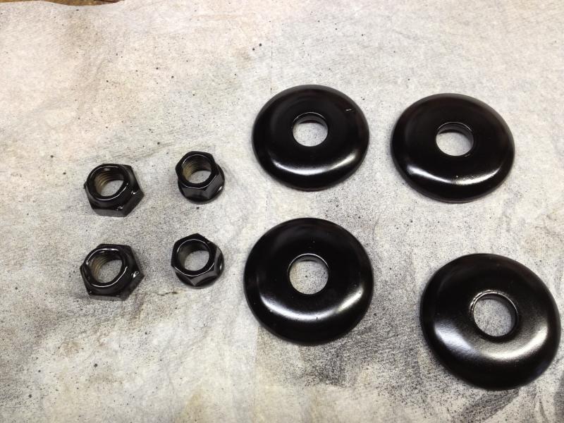

My painted small parts after my Eastwood cleanup...

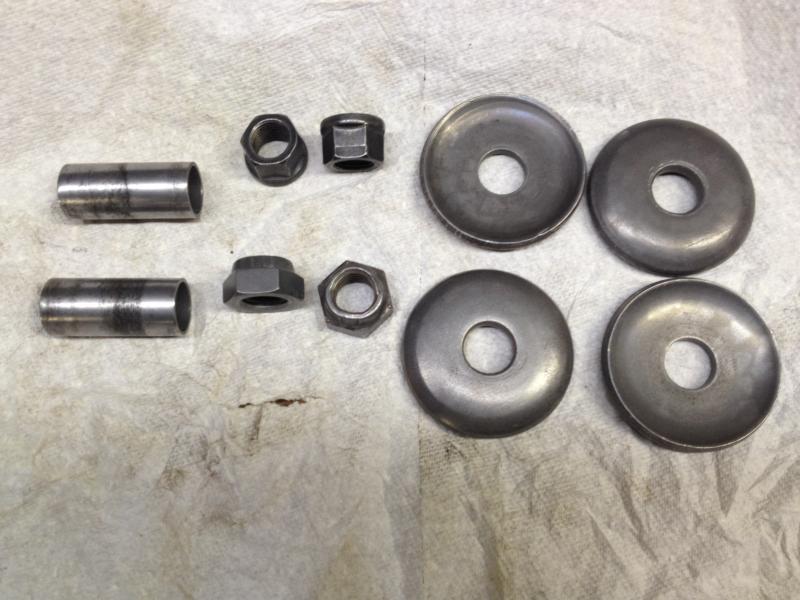

This is the nut I can't tighten. It is a jamb nut, and it just causes the whole shaft to turn...
I believe you are only supposed to finger tighten the nut until you have the suspension in and the weight of the vehicle on it...the Service Manual say to do it with the tires on the ground, but a jack under the lower control arm might work as well so long as the other side is supported...either way, it's spinning because you don't have the full weight of the vehicle on the shaft pinning it so that it doesn't spin when torqued.
There are quite a few suspension components that you will have to re-torque once it's on the ground.

Thanks. I guess I need to put weight on it. I do have the FSM, and I did actually see that the parts need to be torqued properly with weight on the suspension. However, I figured I would pre-torque the nuts and check them again once I had it all back together. There is now probably 3/8" space before the nut even touches the K-member.
Thanks for the help. I guess I will jut need to wait with these until it is back on the car...
That does sound like a concern... I didn't realize it was that far out. Not sure I would want to put it on the ground without the nut at least finger tight flush... maybe if you put some pressure on the LCA up near the bushing you can get a little pressure on it, enough to get the nut flush up against the K-member.

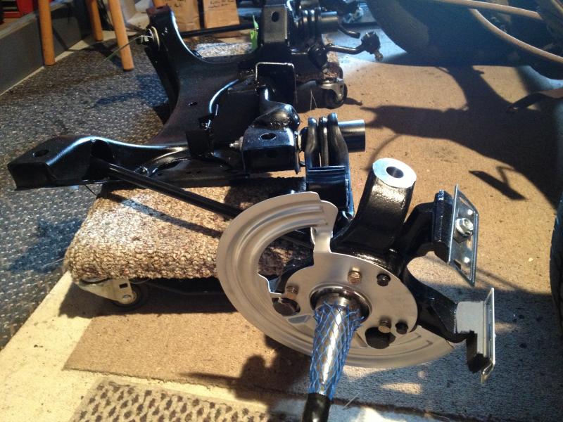

Spent some time working on my son's 73 Road Runner this weekend, but did make some progress on the K member.
I took the pivot shaft nuts off and then "installed" them in the old pivot shaft that I had clamped in a vice. This opened up the new nuts a little bit so they were not as tight. I was therefore able to get them back on and seated. I obviously still need to torque them to proper specs when the car is on it wheels, but I feel much better now.
I also got some of the front brake parts attached as well. Now on to the sway bar and steering parts.
