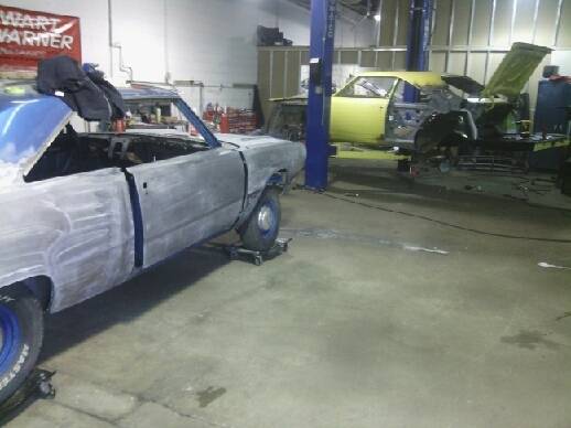

so its 4 am monday morning, got up to take a leak an hour ago now i cant sleep, wtf ............. anyway, ducks in a row at the shop; will be working on 2 70 RR's in a few hours.........and bracing for another snow event......... is it spring yet?

TWO Road Runners??? There is only one that matters, and that's the Green Machine!!! :icon_lol:

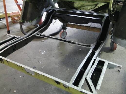

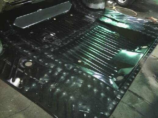

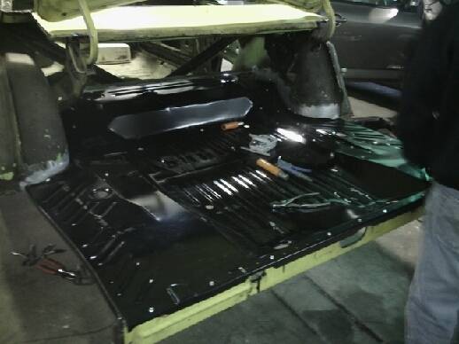

por15 inside the rails...... weldable zinc primer on the flanges........ trunk pan installed
should be repairing wheel houses and fitting quarters and on her next week

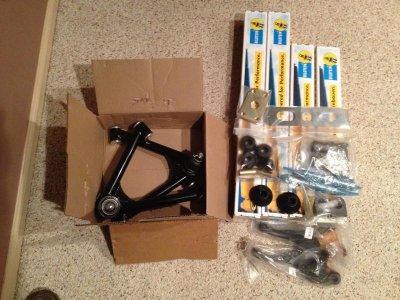

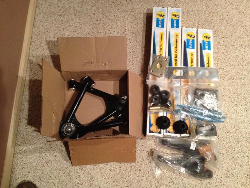

Speaking of fresh, check out the fresh parts that the mail brought today! I ordered front suspension parts, shocks, and a few other items from PST. Everything worked great - I ordered it on Sunday and got it today. Wow, that was fast!
I think I now have all parts I need to rebuild the front suspension. I plan on starting that on April 5th - can't wait!

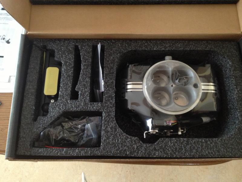

Fuel Injection arrived today!
Honestly, I wasn't sure what to choose - they all seem very comparable. FAST makes a drop in distributor that will work with my 383 so I figured I would go with that system. I don't have that yet, but that should be coming soon.
It will probably be awhile before I can install this, but it will be fun to do. I hope it makes for a really nice running car that can reliably handle the long drive around the country without any tuning - low land Mississippi to mile high Denver... (and this is good because I suck at carb tuning) :icon_clown:

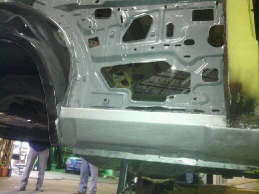

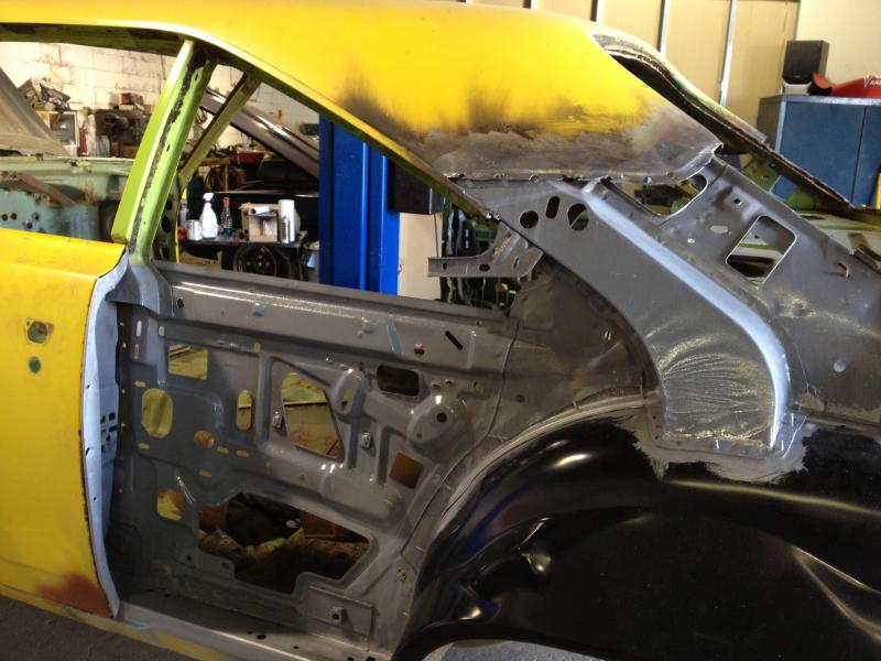

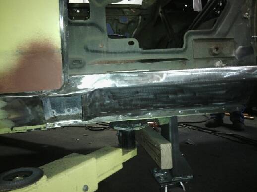

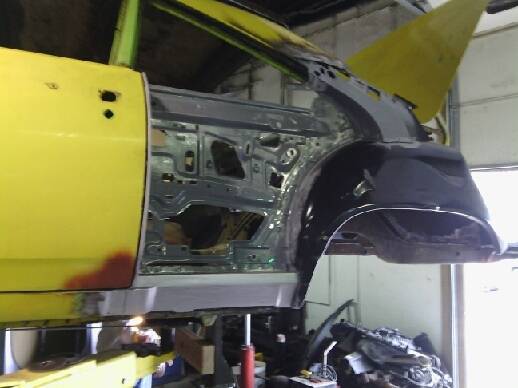

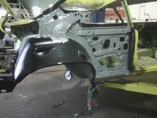

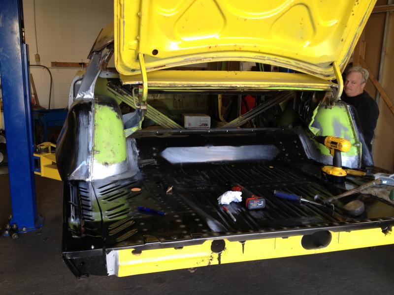

made some good progress the last couple days........... wheelhouses and drop-offs screwed into place, ready to weld but not till quarters are fit up, minor adjustments may be necessary......... small patch was needed in drivers side rocker where quarter attaches.
notice the original lime green on the inner wheelhouses, someone covered it with undercoat when the car was painted yellow..... we washed it off with thinner and a red pad
Wow! Cars are looking good. Looks like you're making headway.

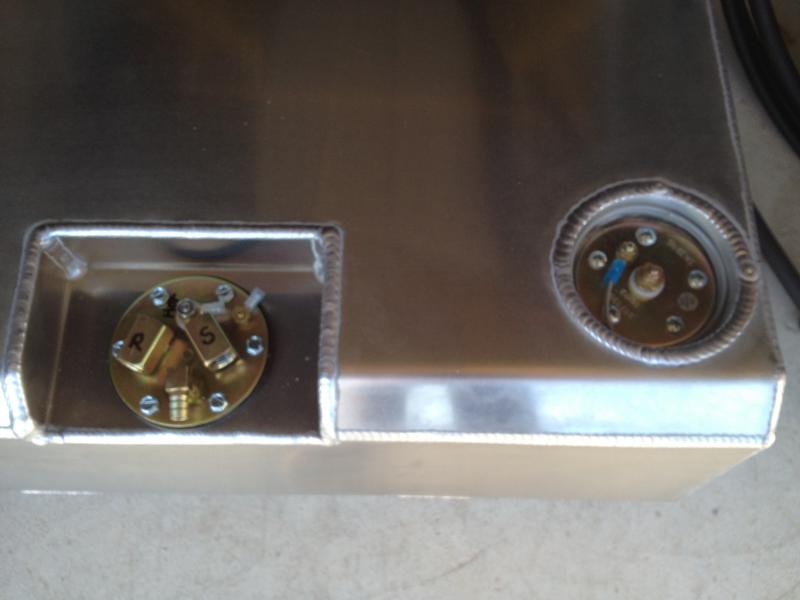

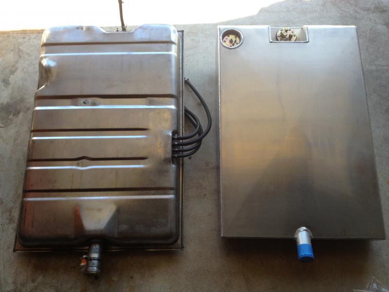

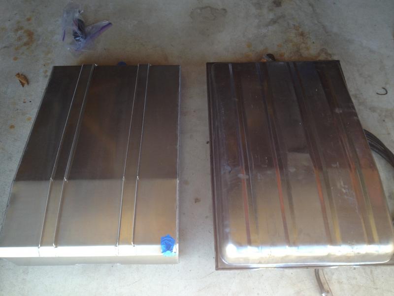

So my custom made fuel tank came in from Hot Rod City. It looks nice. The only complaint I have is that the filler neck is not quite straight. I hope that does not cause any issues with where the gas cap ends up.

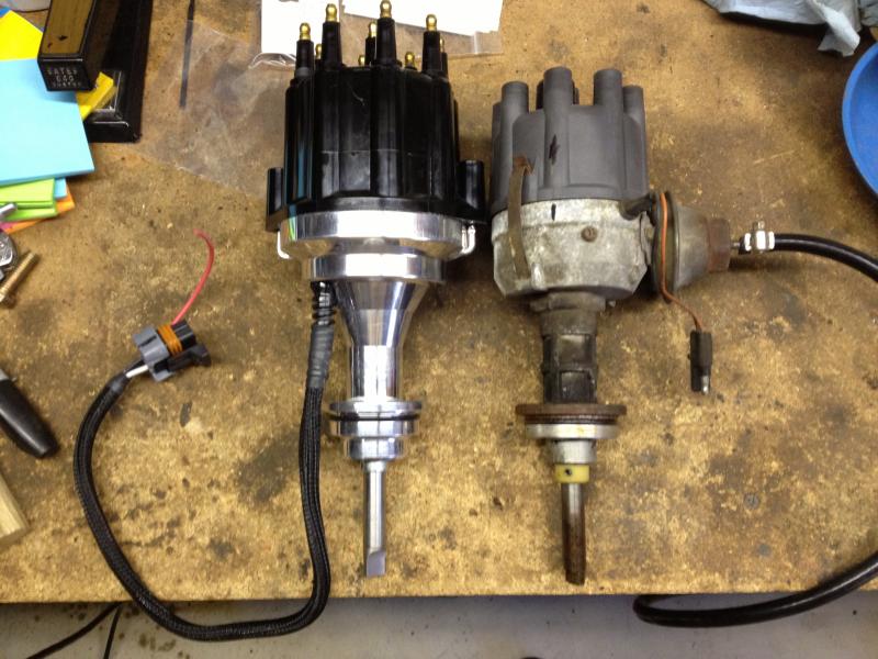

I also received the new FAST billet distributor that works with the FAST system and controls timing. Too bad it is a GM cap... :angryfire:
A couple of the tank:
And the new distributor compared to the original:

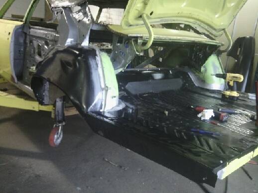

I visited Mark and Tom at Apex and checked out the car. The work so far looks great. We decided to order some more parts to truly do a first class job on the body. It will cost more so I will have to cut out some other budgeted items, but other items can always be added later. I want to do the bodywork on this car only ONCE!
First, a couple of pictures of the car. Here is the back end of the car.
Here are some of the "guts". As much as possible, all hidden areas are being protected from future rust...

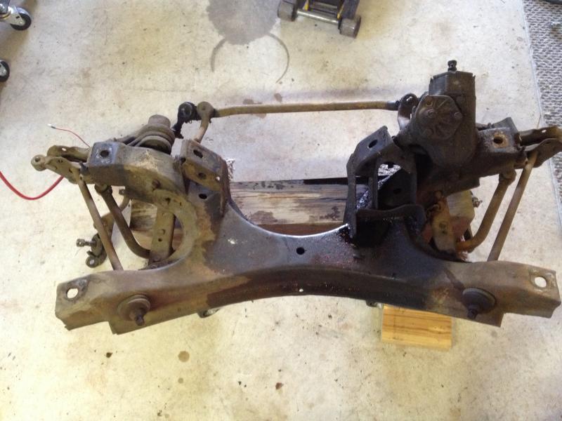

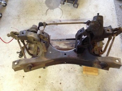

Back at home, I separated the engine, trans and K member, and I have now started on the K-member clean up.
My car handled OK, with no goofy shakes or wobbles. But, look at the control arm pivot shaft bushings! I would never have guessed they would look like this! Good thing I ordered new ones...

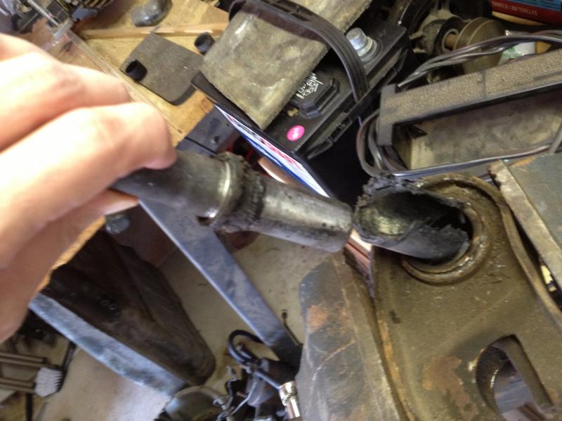

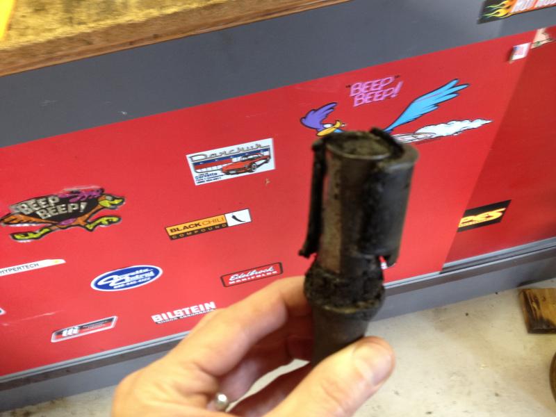

OK, I just got through one of the more frustrating tasks I have done for a while.

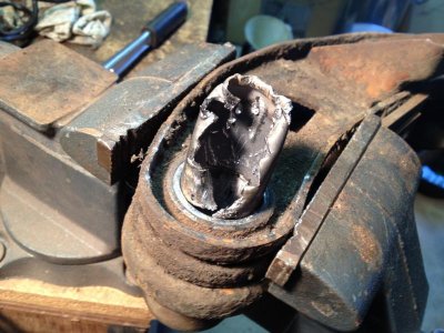

Removing the steel bushing inserts from the control arms is NOT EASY, at least not for me. The FSM states to "chisel them out" and then goes on to state that you should be careful not to damage the control arm.
RIGHT.

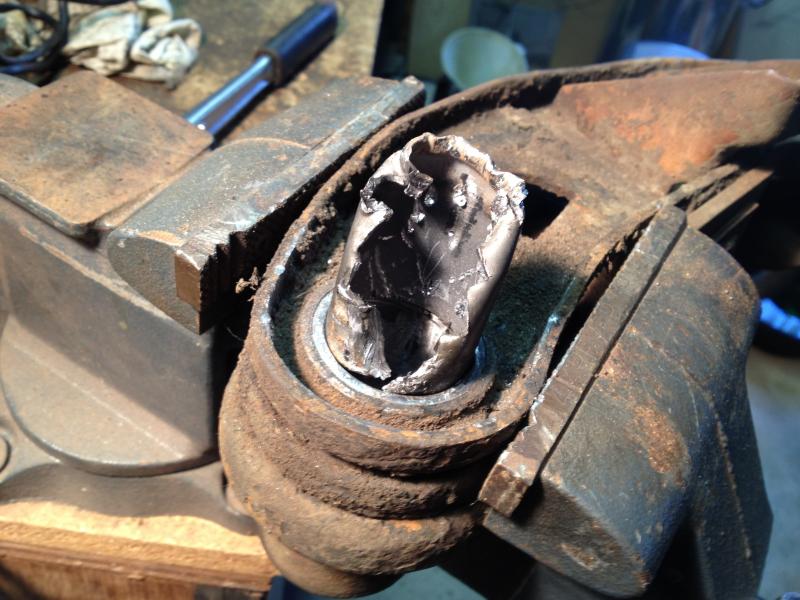

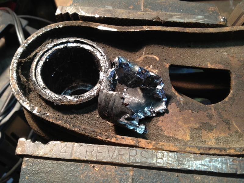

The steel bushing inserts are thick and pressed into the control arm. Chiseling them out is no picnic, and I really struggled. Even though I tried to be careful, I did put a couple of gouges in the control arms. By the way, how the heck are you supposed to be careful when you need to bash the sh** out of the bushing???
At any rate, I got them out and then used a Dremel to touch up the gouges and be sure the inside was smooth.
First Control Arm:
Second Control Arm:
Now to finish cleaning up the control arms. Then I will weld the stiffening plates on to them, paint and assemble them...
One way is to take the blade off your hack saw, put it thru the hole (bushing) re-attach to the handle and cut thru the sleeve. It will come right out then.
