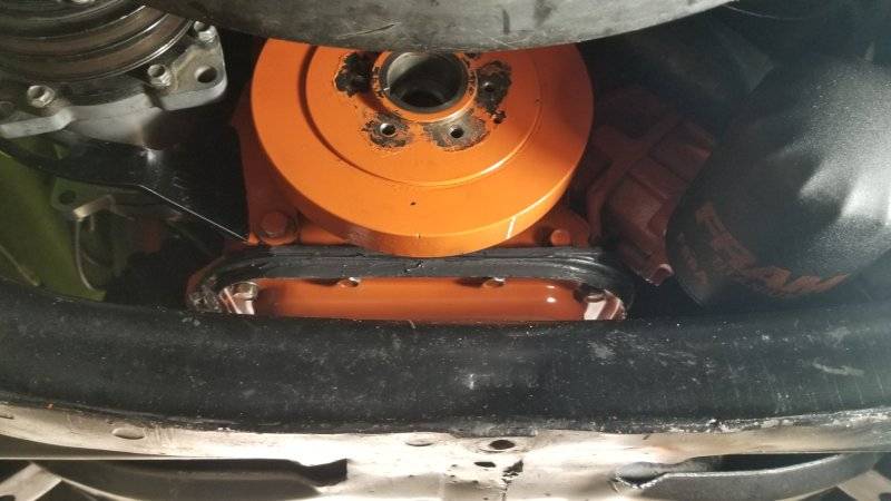

But seriously, the day has had some positive aspects. I drove around this morning and the leak was significantly reduced by my RTV experiment. The problem was, I could see that the oil had made its way through patches where I didn't get good RTV coverage. With the damper in place, I missed whole areas because I couldn't smear RTV there. Also, some RTV (after about 12 hours of curing) was still wet. I had gobbed it on too thick in the corners.
When I pulled off the RTV, it is obvious that the bottom corners of the timing chain cover are the culprits. I'd love to really pull the whole timing chain cover and I will do that later in the year, but I am out of time for now. So I pulled the damper off so I could get good access to the area. I then cleaned the area way better than last night, and then strategized on how to put a thin but unbroken layer of RTV all around the problem areas.
I know the picture below looks bad, and I wouldn't suggest this to anyone as a proper fix. But I'm hoping this round, done very carefully, will keep the leak at least slow enough to allow us to take the car on the journey.
Given that the last batch wasn't even dry after 12 hours, I will not even test this until late tomorrow. At that point, it is do or die. It'll work or it doesn't. I am out of time for more fixes. If it is unacceptably bad, then I'll have to go to my beater backup, the RoadKill Runner:
