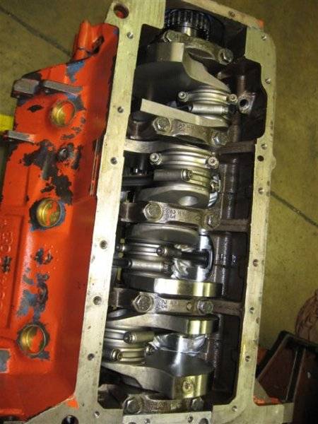

Well, I for one am following, Hawk. I want to see what those ultra short piston skirts look like now. I don't know if I mentioned it to you before, but the bearing clearances were originally set on the loose side, and I always used 20W50 oil because of that. Here's what it looked like when I originally put it together.
Great pictures of when the engine was originally built!
By the way, this engine put out 550HP with cast iron heads on the dyno. Aluminum heads were later added which, according to my father-in-law, should be good for 50-80 HP. So let's call this a 600HP engine, give or take.

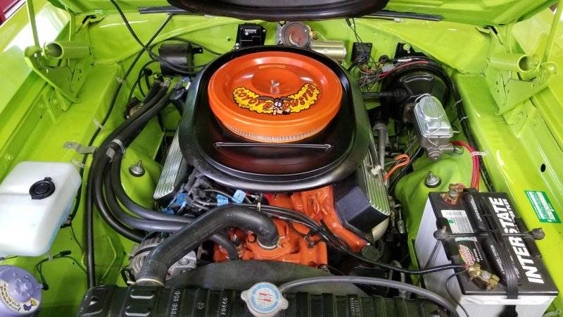

Here is what it looked like when it was installed in my car:

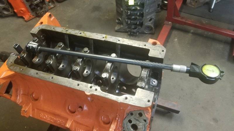

As with my "RoadKill" 73 stroker motor build, the block is the foundation of the engine, and the mains are critical to engine longevity.
You want to measure both the size and taper of the mains. Below is a picture of my block with the tool that measures bore size down to .0001".

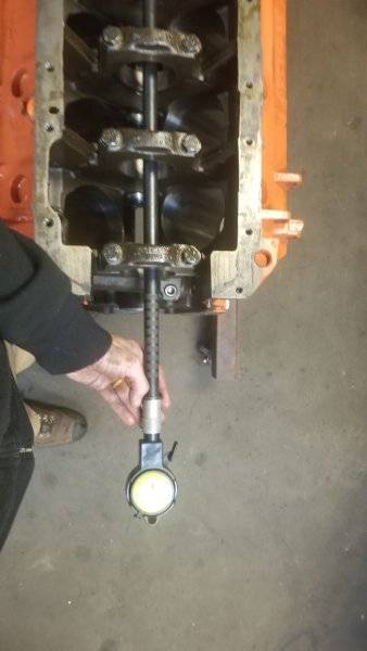

Here is a rough picture while measuring one of the mains. It is a bit hard to take a picture while doing this, as even a tiny movement of your hand make the needle move a lot! Bore is measured on both sides of the oiling hole.
The good news is I do not need to align bore this block. All bores were on the tight side of the spec (that's great). Two bores had .0001" taper, one had .0002" taper, and two bores had .0003" taper.
.0003" taper isn't perfect, but that's still OK. I may try to just touch these and see if I can improve them, but even if I run them with .0003" taper that should be fine.

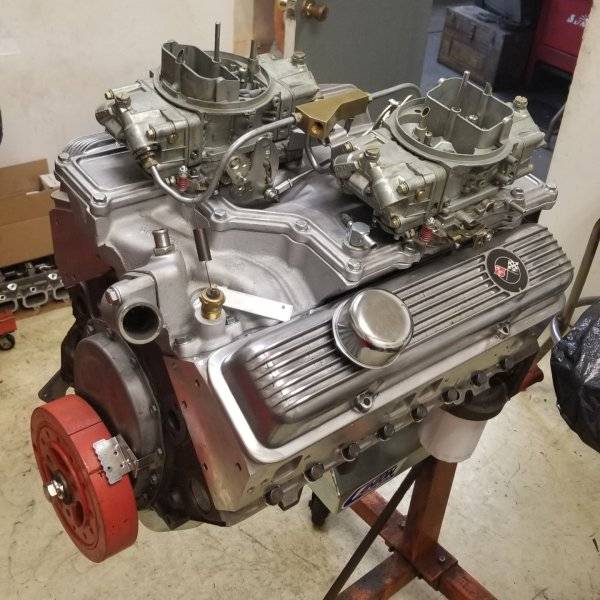

I am finishing up building a 302 for a Camaro Z28. Hopefully this will be pretty much done next week so I can devote more time to my engine build. I know, it's a Chevy, but it still looks cool with the very rare cross ram manifold!

I have the exact same dial bore gauge with the setting fixture, I have the shorter one for rods and bores with its setting fixture as well. That is one pricey gauge, especially with the fixture.

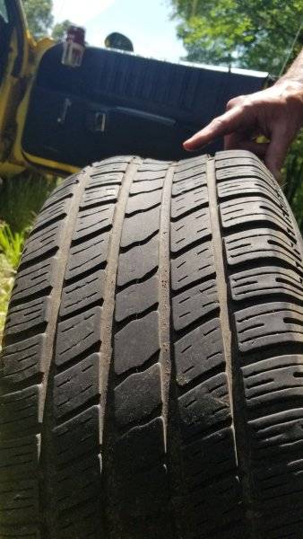

BTW, how's the tires on the RR? :poke:
Why would you ask about my tires???
Oh, yeah, that's why:
The tires on the 70 are 7 years old. I would say they should make it, but that's what I said about the tires on the 73... :poke:
I'll be near Pittsburgh Monday night.
Yeah, Sunnen doesn't make cheap stuff. But it works extremely well - my father-in-law insists that all gauges get treated like they are Tiffany works of art. But that makes sense - it keeps them accurate and working well.
