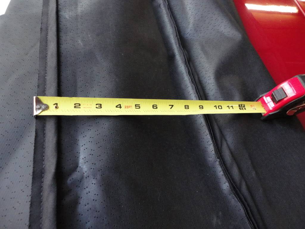

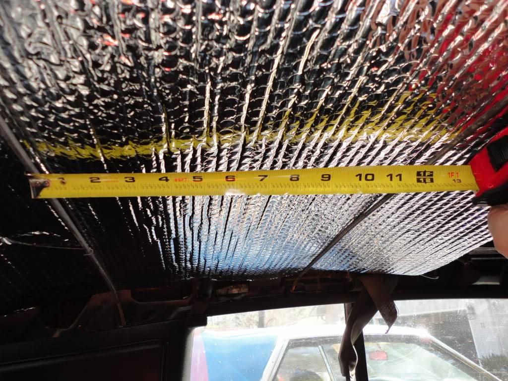

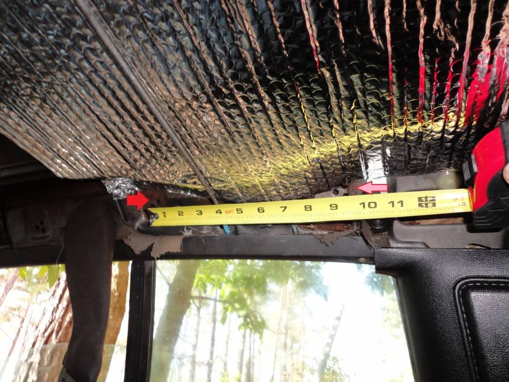

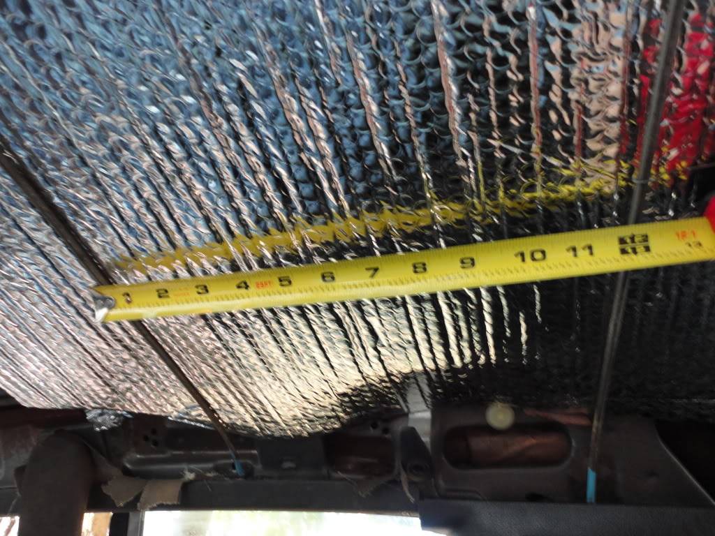

There is no where near enough stretch between the two bow seams. I am using the original, undisturbed bow order and location after just pulling the dry rotted headliner off of them.
I did put insulation above the bows, and also left the original rear tensioners in place after scrapping off the dust remnants of the original padding.

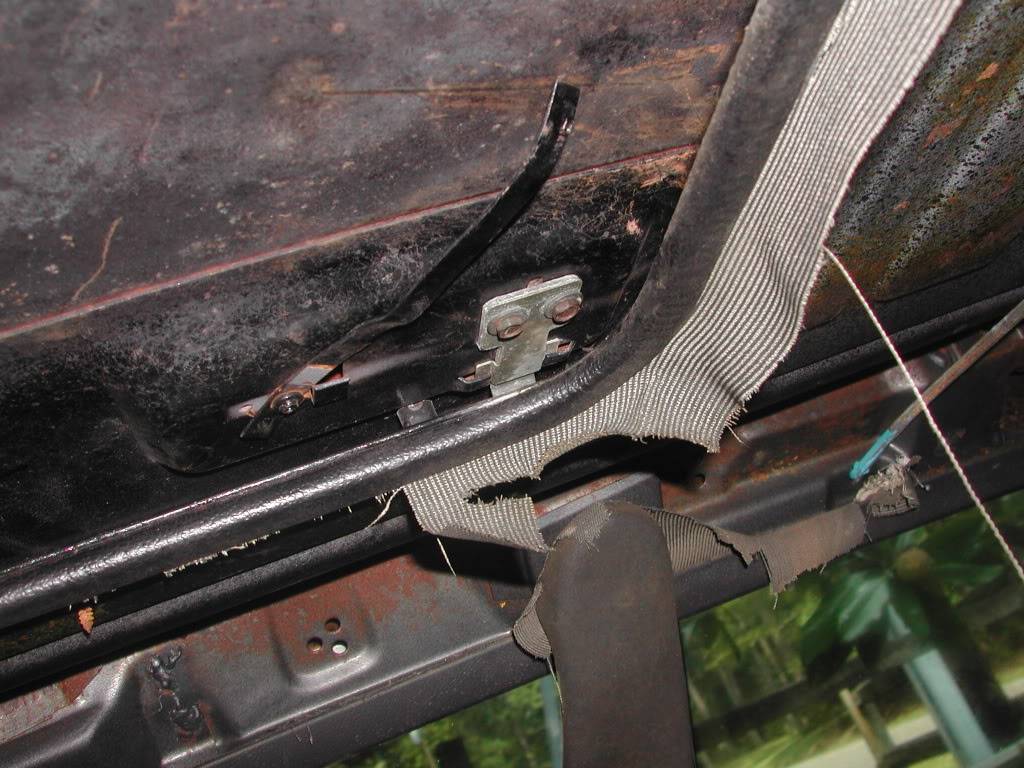

These bow holes cannot be used for a sun roof (the sun roof pan comes too low, that is why there are lower sun roof bow mount holes.
Now, with the original bows and their location

A picture of your headliner, with a measurement between the seams would be of great help to me.
Thank you for any help. I know there is stretch in a head liner installation, but two or three inches out of nine or ten inches of material is way more than I can get.

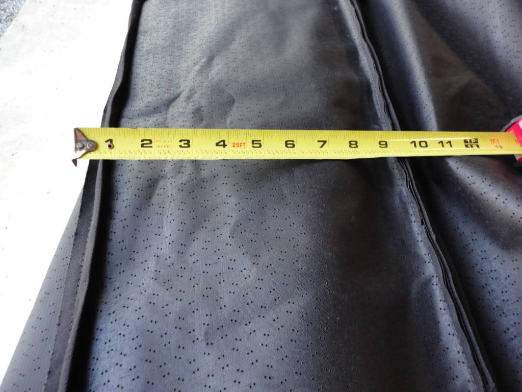

Sorry to take so long to get back to you. Been really busy. On my headliner, the bows are 12" exactly, center-to-center. Has your issue been resolved yet? My headliner is out of the car, and ratty. But complete! I'm willing to let you borrow it to use a a template if needed. Let me know.

That extra three inches sounds just right from what I measured and very glad to here it from an actual headliner.
I think the non sun roof ones must be 9 inches,
and when they made my 2 bow sun roof one just used that measurement instead of the 12 inch two bow one.

LAI got back with me and refunded me, but say the template is not in there system and that they made the right one. He was nice and open to the possibility that the Charger and RR have a different one, but does recognize the bow holes in the pics are 12 inches apart, not 9, and that with the factory sunroof pan there is no room to put the headliner in the 5 bow non-sunroof holes.
