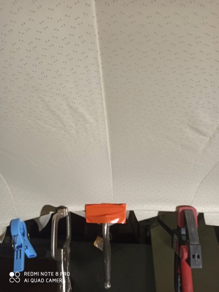

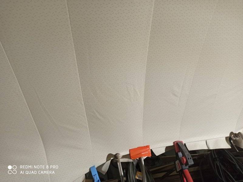

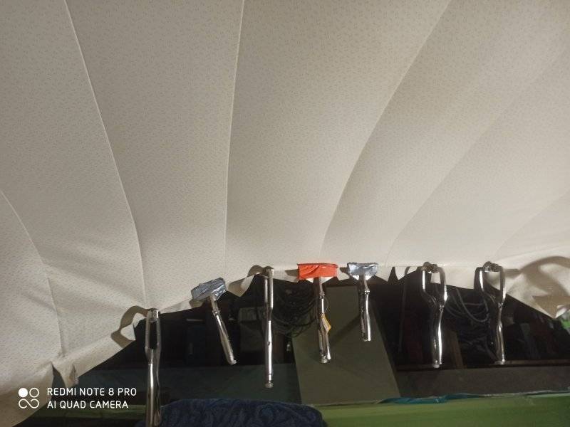

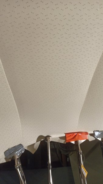

Hey doing headliner 1st time, got it rigged up prety tight but there are wrinkles fold lines still left... Is there any way to work those off afterwards if I go ahead and glue it in place? Or is the only way to get rid of them heat and pulling it tighter when gluing?
Tips appreciated
I helped on a buddies nova years ago. Wrinkles larger that that. I used a kettle with water in it then followed up with hair dryer. (before internet and amazon) Be careful. The wrinkles really shrunk. I noticed that it pulled really tight along the edge. We got away with it, but I could see someone getting in trouble and shrinking it too much. Use the old vantage. Little at a time. Plus common sense. Good luck.
Bought 30eur steamer and some spray starch, worked wonders. Seems to stretch the material slightly so i guess better to get fold lines out before gluing. Results:

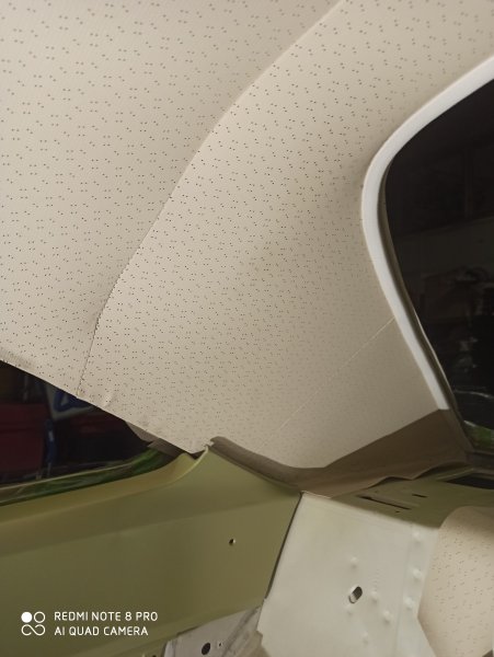

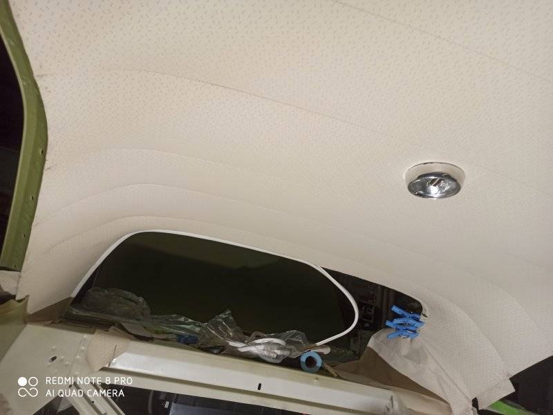

Getting er done bit by bit, tedious work to glue small portions at time... C pillar abit finnicky to get installed without wrinkles. Snow on the ground here, would imagine this ti be easier job in summer heat

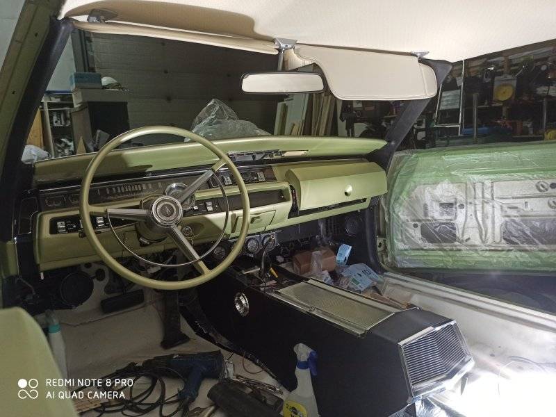

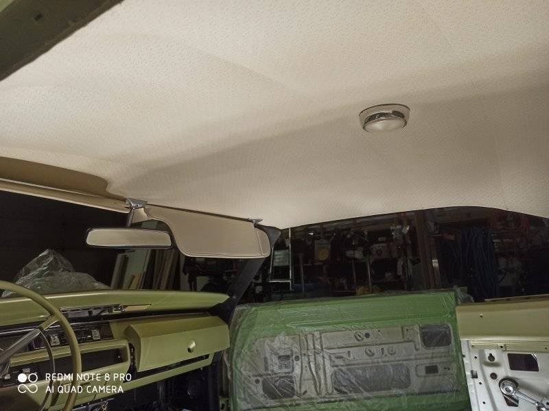

No clue how they did these in the production line in time but its possible to do it by yourself if you take time massaging, im prety hapy with the end result.. finally can start to button up the rest of interior
