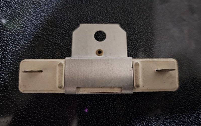

Btw... I have no ballast resistor. I've got you all beat.

The "real" fix beside the ballast resistor is the "GREEN" axle bearings.....which are attributable to just about all rear end difficulties.......said with sarcasm and tongue in cheek.......What size ballast resistor do you have?

A ballast resistor.What should I look for?
This is bordering on hilarious.....A ballast resistor.
