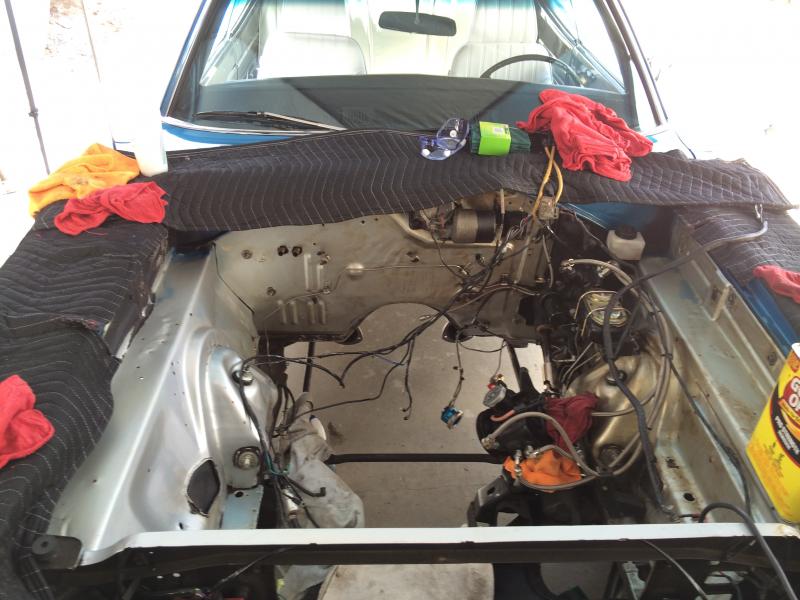

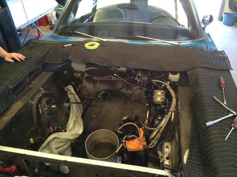

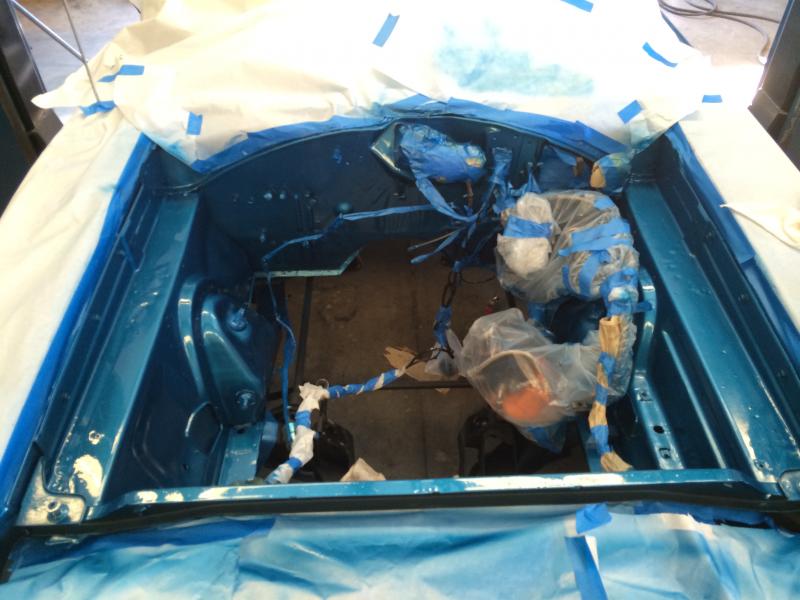

Here are a few pics of work to date. Engine is out and the bay is cleaned out. Today,detail clean around the seams, scuff, clean and spray QQ-1 blue to match the outside!
Engine ready to come out...
All the black goo that was sprayed in the engine bay
All clean and ready to finish...
Nice job on the engine compartment cleanup. What method/material did you use?
Next Step...
Finished!
It turned out great! I am stunned by the paint match..
To get the goo off, I used Goof-Off. Nasty stuff. I used a respirator and multiple pair of gloves.

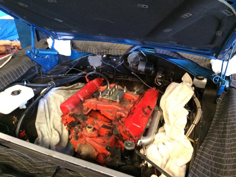

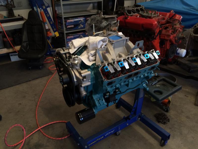

Here are the latest pics and a pic of the new "Heart" for the GTX....

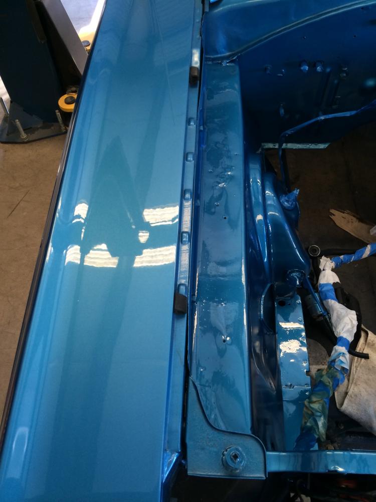

Here is the finished engine bay; still with the masking on the fenders
This shows the match between the fender and the inside of the bay
And this is the new 'Heart" The carb was out getting dialed in by a former Holley carb expert. According to the mechanic doing the work on the car, that guy has forgotten more about carbs than most of us know!

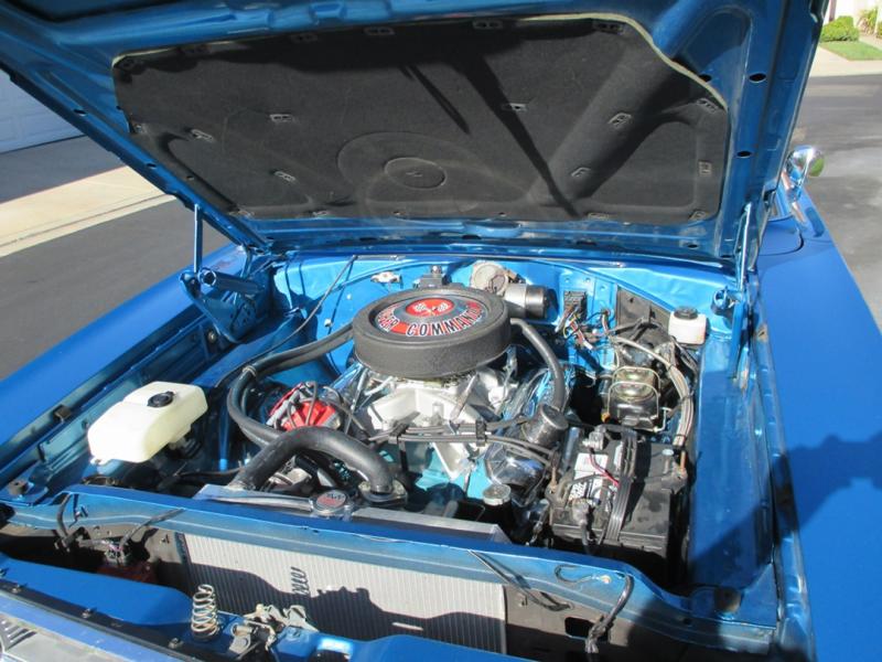

Here is a pic of the almost finished project. Still need to pick up my new valve covers from the powder coater and install those. Then it goes back to get the torque strap installed.
After what it looked like in the engine bay before, I am really pleased with how it came out.
Now I will open the hood more often!
Jeff

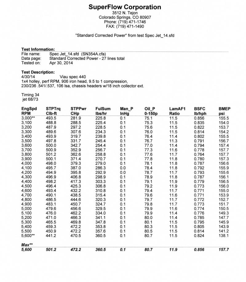

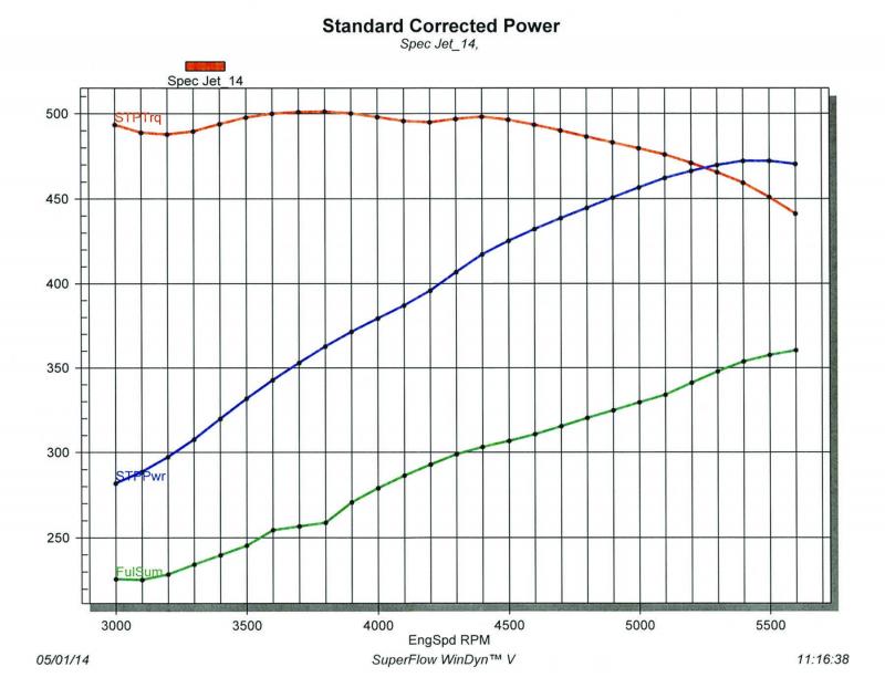

The torque curve is almost flat from 3k to 5500 with 495 - 501 ft/lbs and it really shows.
Here are the dyno charts:
