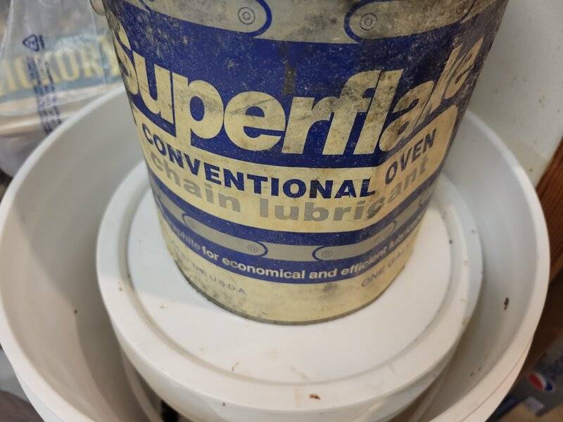

The factory stuff was graphite based spray, still sold part #4318039ad. nothing really lasts due to heat and exhaust pressure, lock ease spray also works and leaves graphite behind. I use superflake oven lube because I have it around. Anything that leaves graphite works.

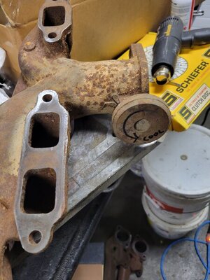

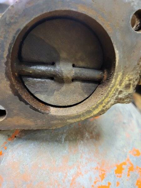

Can the heat riser be tested prior to mounting the manifold back on. The butterfly valve swings freely. Can i heat it up to see if it opens properly ??
Sure, just use indirect heat so you do not get the spring too hot with a torch.

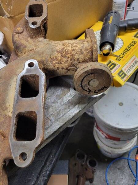

Without using heat, can you tell me which way the counterweight turns ( clockwise or counter ) when mounted.
Pic is direction it turns as it cools. It will not move as you heat it exhaust pressure does that, that is why proper position before welding flap is important.. Heat gun did fully heat the spring enough so you can watch it close.
Thank you for taking the time to answer my question. Mine should work properly.
