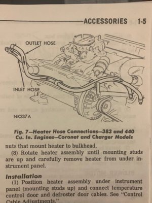

Good Day All,
So I have few questions regarding the correct heater hose set up for my 68 Charger 440.
It is a non A/C car. The short/low bracket on the passenger side valve cover. I have the correct numbered hoses....1300 523 and 2435 961.
My outstanding questions are...
1. Confirm that the hose labeled 1300 523 goes from the firewall nipple closet to the engine then crossed over to the outside water pump nipple?
2. The crossover in the hoses occurs between the firewall and the bracket on the valve cover? See attached photo from FSM.
3. Reading the numbers on the hoses after installed...should the numbers be "upright" as reading from "standing outside the engine" or as if you were "sitting on the engine"? I have seen both arrangements in photos from experienced builders.
4. Are there any aluminum straps that would go on the hoses as per factory and what are their placement?
Thanks to all who can help

I got the "beat down" from a few friends for not having my hoses crossed per the service manual on the X.....I had to succumb because the judges would pick that error out.....I fought hard on this fact and I had proof showing survivors without the hoses crossed...
The straps were "plant" dependent.....this is also a well debated issue amongst the OE crowd....My survivor 69 charger had them but the GTX the hoses were changed. LR supposedly didn't use them based on a highly credible source.....
Things is on the line they didn't give a rats azz which hose went where and if a strap or two was placed....
I'm still baffled as to the two different part numbers, since it was the same sized hose! Can't help you with correct #'s for '68, could for '69.
BTW.. installed mine like the line worker that originally installed them. A "hip mickey" and a good joint first, no cross. :fool::D

Yep.. '69 looks so much cleaner in parallel, but on the '68 with rocker cover bracket (vs the '69/70 fender bracket) I'd do it per the FSM as it looks right that way.
