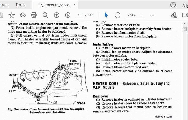

On the heater hose brackets, I have seen both on 67 Hemi's, so I just need someone to tell me which one is correct.
Do you guys need heater hose in TX or AZ.:rolleyes:View attachment 1186554
Fran what year service manual is this page from? I'm curious to know what year because of the heaster hose bracket they show attached to the fender.

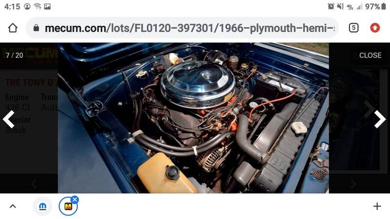

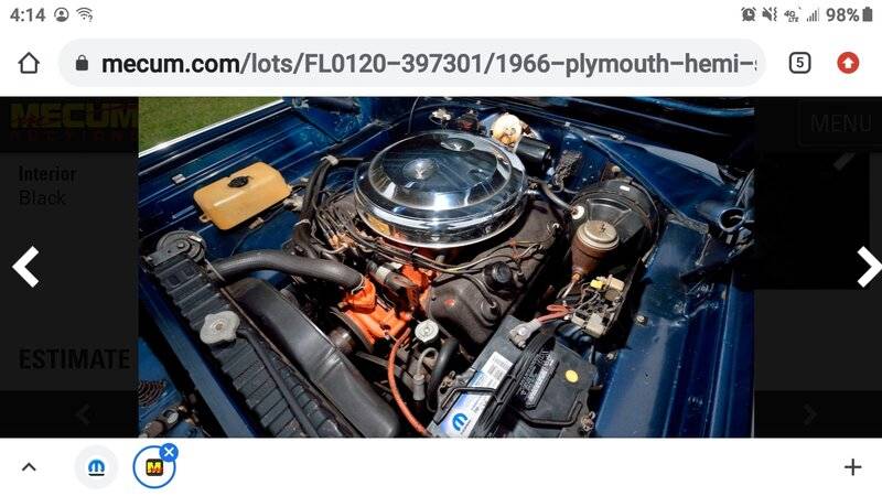

The voltage regulators on the 66/67 era pictures of Chargers in old magazine road tests show the voltage regulator mounted higher up.
67 they don't show Hemi in 66 SM same no Dana 60.
Not crossed.
This is an unrestored 6000 mile car.
And how i have mine
