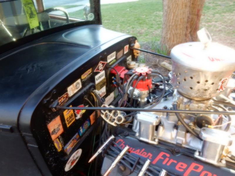

Put a Pertronix in your Chrysler distributor,thats what i did and it works great.get the Ignitor II and use their coil and you can bypass the ballast resistor.
