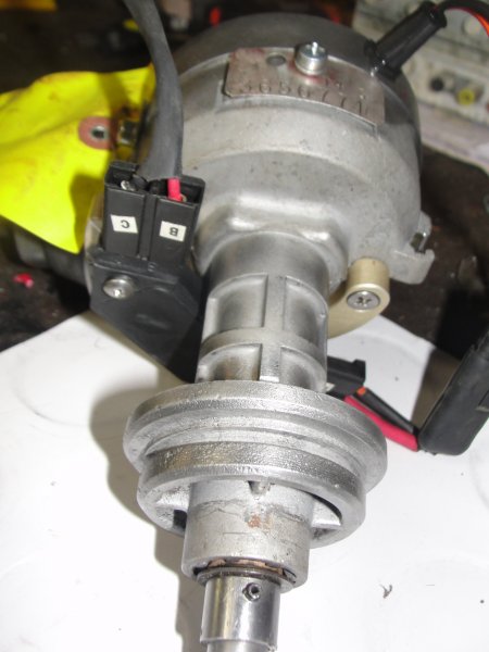

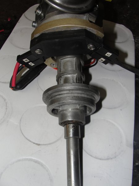

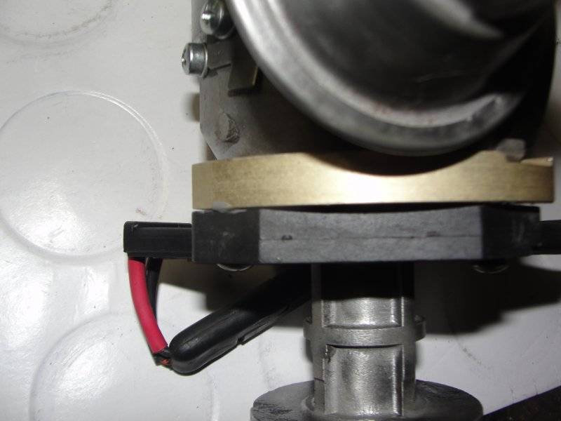

I have used heaps of Chinese HEIs over the years in different engines. Only one has 'failed', owner claims it was the coil, but I never saw it to verify it. I strip these dists to modify the centri curve. They are all well made, tight clearances, parts are lubricated. Centri weights, centre plate are chromed, originals were not.
What I do for the GM 4 pin for people.
