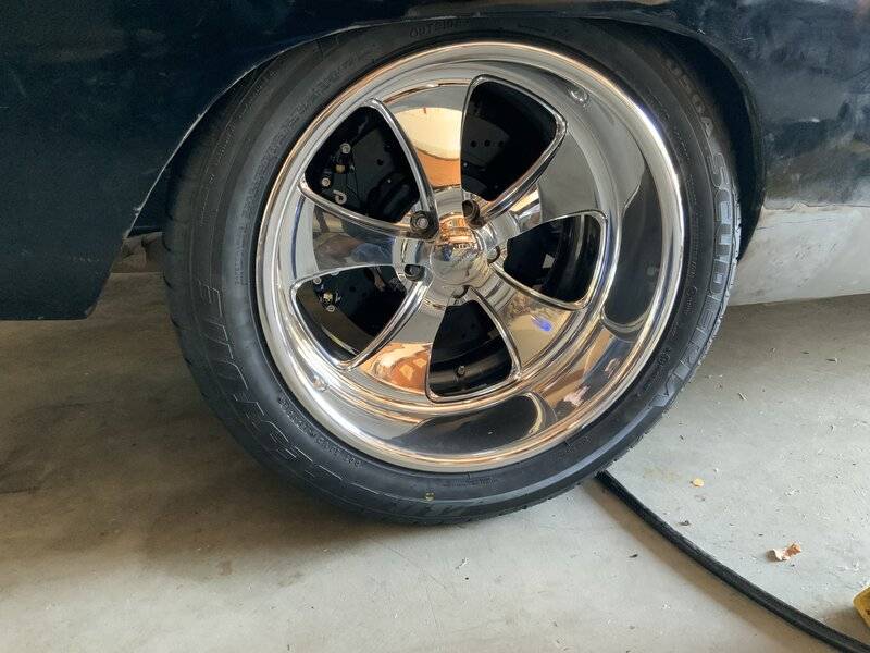

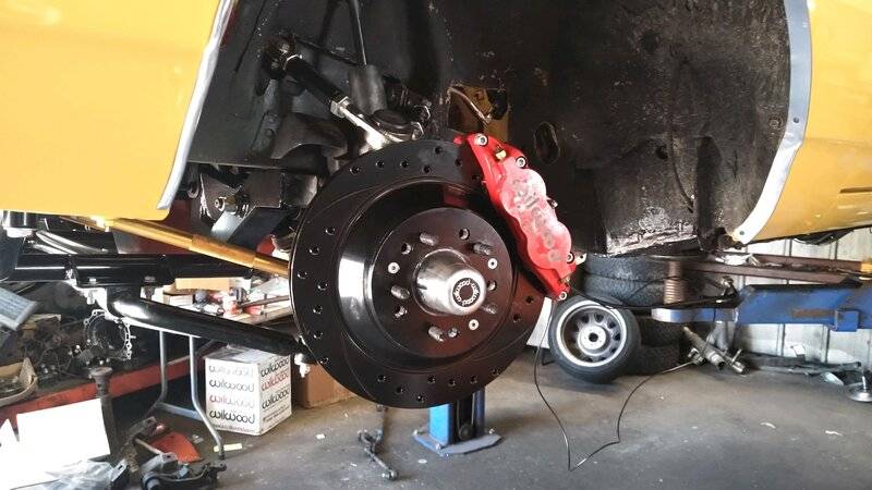

I am looking into that Alterktion front end. What do yall think is the biggest disc brake setup that will fit with that front end, strange dana 60 rear and 17" Ralley's?
This was for the factory stock or QA1 front suspension! YRMV!!

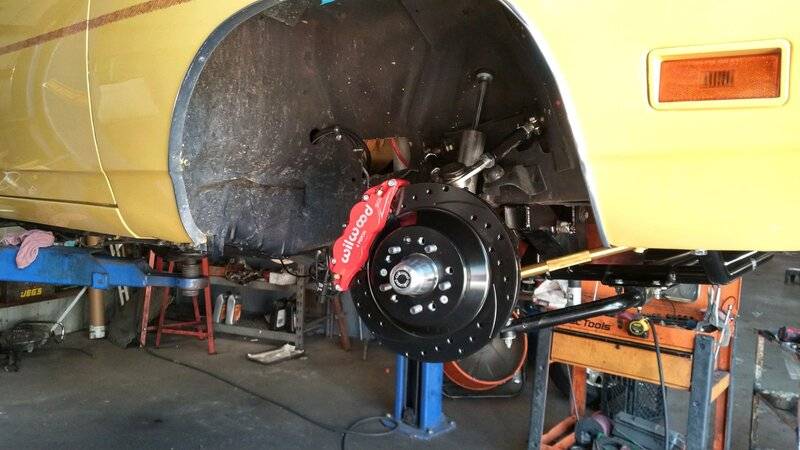

I got my 4 wheel, :carrot:6 piston:bananadance:
Wilwood disc brakes from Quick Performance. I have yet to see another Wilwood 6 piston disc system on all 4 wheels, although I have seen a couple of Baer 4x 6 piston disc brakes systems on B-bodies. Quick Performance knows how to make that happen. Neccessary? No...

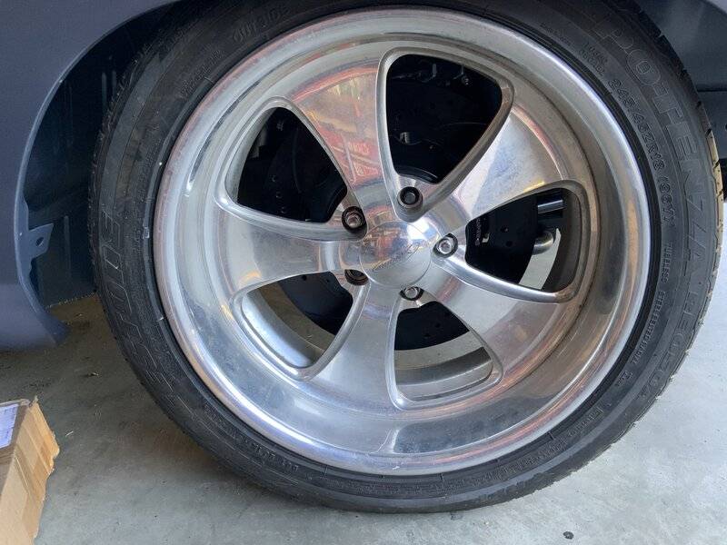

Absolutely cool as heck and a bragging point? Well, YEAH! I have the 4½" backspacing 17 x 8" front aluminum Rallye wheels and 5" backspacing 17 x 9" rear aluminum Rallye wheels.
Anyway, I have 12.88 front brakes:
https://www.summitracing.com/parts/wil-140-12282-dr
and 12.19 rear brakes, with the "Quick Performance Special" 6 piston upgrade.
These, but I paid $300 extra for the 6 piston caliper upgrade:
https://www.summitracing.com/parts/wil-140-7144-dr

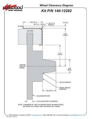

Here's the front 12.88" dimensions for clearance (sorry, best copy I can find)
By the way, LOVE my 17" aluminum Rallye wheels, and I am going to see what backspacing I need to go radically wider when/IF I likely frame rail relocate and "mini tub" with the new AMD wider wheel tubs. Anyway, at that point I want to have the aluminum Rallye wheels widened, but to keep the look I have now.

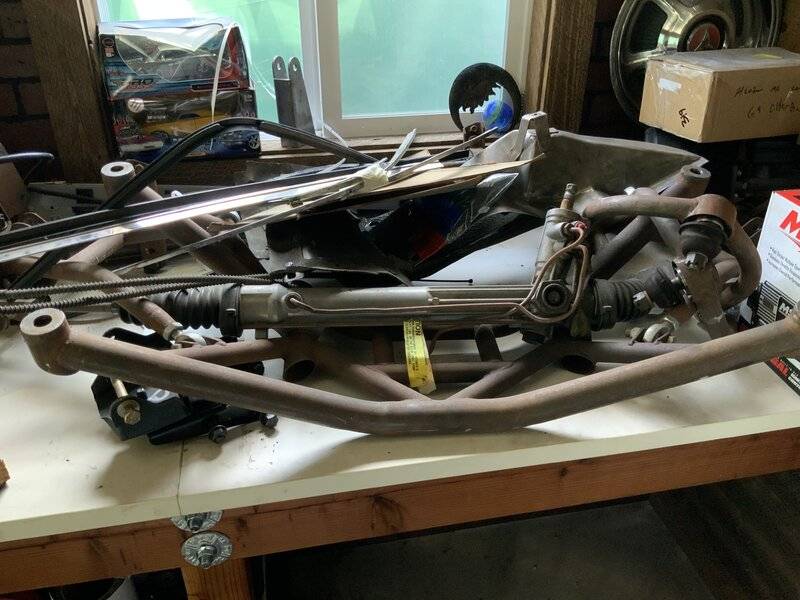

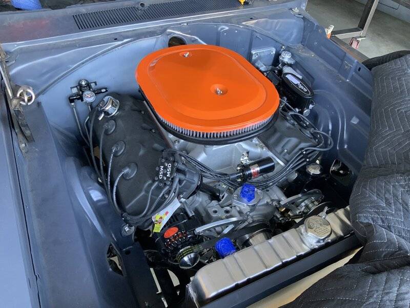

I have 14” breaks there will fit no problem ,also have a magnum force front end sitting in back shop garbage Ron does not tell u the k member also pushes out wheels slower to outer fender then stock location , also have FHO hemi 572 love it but the price is closer to 34$ about ten more then hellcat crate
still building car
As far as stock hood i just mounted mine and air filter hits I’m thinking because the motor mounts (TIN MAN) are slightly higher then stock mounts also this a 69 charger stock Kmember

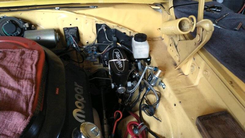

@Jesse6869

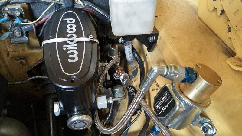

Is the billet aluminum hydraulic reservoir in this cropped picture of your engine bay for a throwout bearing?
After my Wilwood master cylinder was installed, that really made the standard white plastic T.O. bearing reservoir look like crap, so I spent the hundo on the black satin billet aluminum reservoir.
Yes, its from ring brothers I’m actually going to change it to the black one later
I looked over the various ones available, and damn they are pricey, but American Powertrain hooked me up, but still...$100 eek!

the Alterktion over the Gerst front end?
Strictly from having met Carl Gerst in person when he was starting out, and a couple of times since then, when I "was certain" that I was going to install a RMS or Gerst triangulated 4 link rear suspension until I succumbed to relentless harassment, led by @vintage chromoly :D:p:poke: to....
Please leave that poor car be.
So instead I have gone with Calvert split mono leaf springs and sliders, and Smith Racecraft Assassin traction bars, and most of the frame strengthening parts that are available, with fender braces and/or J bars to be added when the 541 stroker goes in....
Anyway, I was considering both.
Gerst has more options, but some require losing the factory fuel tank.
Look at both, talk with both, decide.
