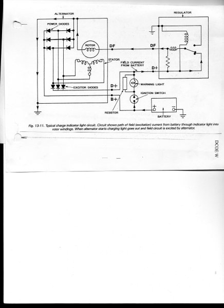

In the diagram of an alt below, the diodes are reverse biased with the bat polarity correct. With bat polarity reversed, the power diodes are forward biased; with no limiting resistance in the cct, the diodes will blow from the huge current surge.
Incorrect reasoning and asumption....once again
The diagram you show is for an early GM alternator circuit, using an indicator lamp in conjunction with a field relay for initial charging and a mechanical voltage regulator circuit, a diode trio (GM's nomenclature) that provides the DC to power the rotor voltage and current. This has NOTHING to do with the "power diodes" which are not reversed biased. The later GM alternator designs use an internal electronic voltage regulator. I suggest you go back to looking a vacuum advance hook ups, and things that you may understand.....let's compare what you think you know to what you really understand.....to your design credentials to mine.....

Geoff 2 is using a old GM alternator circuit to "emphasize (?)" the point of hooking ip the battery charger in reverse. The designer of the origional alternator circuit (and subsequent revisions) has selected diodes whose PIV or Peak Inverse Voltage capabilities (reverse voltage and current) exceed the possibility of putting 12 volts in reverse order. It is highly likely that the diodes selected have a minimum of 200 volt PIV level (possibly more). Thd only way to determine the diode's PIV voltage AND its forward amperage rating is to look up the diodes rating by it's number; ie, 1N4000 or similar designation against design capabilities by manufacturer. Making incorrect or inaccurate assumptions causes the lesser knowledgeable readers down the wrong path......moral......get it correct or say nothing......
