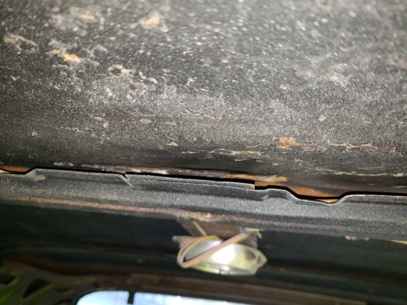

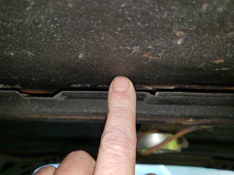

The roof supports have become unattached from the roof skin. They are about 1/2 inch below the skin. The question is if I force them back up and reattach I am afraid it will pull the skin down an deform the top of the car? Should I be worried about that?
It takes quite a bit of force to push them back to contact with the roof, if I force them back up and attach them, when I release it , do you think it will deform the roof?
Also how would I reattach it, I do not think seam seal will hold it up, jb weld maybe? Or should I just fill the gap with foam and leave it? Will it interfere with the headliner if I leave the gap?
Leave it alone or use a foam. The roof is a large piece of metal that will buckle and ripple easily and being it is eye level you are gonna see it. Let it float or use a soft non expanding foam.

You don't think it will deform the headliner? I have not seen a headliner in this car so not sure how far down it hangs, I don't want the support to show through it though. That is why I am worried abut leaving it as is and filling with foam. If the headliner hangs far enough down, I am thinking the same as you, leave it and fill with foam
I’d follow @Dibbons advice. He has first hand experience with it, also if you look it appears there is seam sealer or some early form of panel bond in your pics, which means Chrysler intended it to touch the roof. The worst your gonna have happen is the roof will need some body work (highly unlikely)

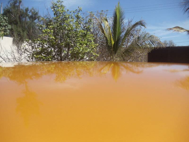

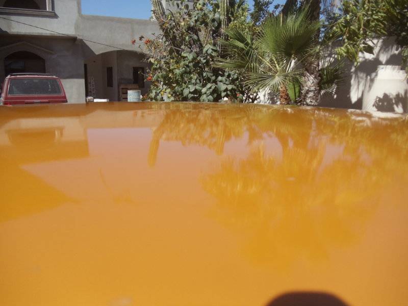

I understand the concern for warping the roof some. In my case, I was more concerned with roof integrity and flex. Repairing the "sunken" supports will put some tension back on the roof skin and change the roof line one way or the other, but I believe any change is practically invisible to the naked eye. Just tell the kids don't use the roof as a substitute trampoline any longer.

By the looks of the picture your brace isn't low enough to affect the headliner. These braces weren't put in place to hold the roof skin, they were put in place to help in a roll over accident. The seam sealer put in from the factory was there to keep the roof skin from slapping the roof and causing noise. It's not a structural bond so don't use something like panel bond. You want the LARGE roof skin to be able to expand and contract with heat and not warp all to **** cause it's glued tight. That's why all large panels like hoods and such use a flexible bonding material like foam. If you push the rigid brace up with a board and glue it, the roof skin will not hold the brace in place. The brace will go back to it's formed shape and take your nice straight roof skin with it and you will be putting body filler in it to straighten it out. But it's your car so do as you wish..
