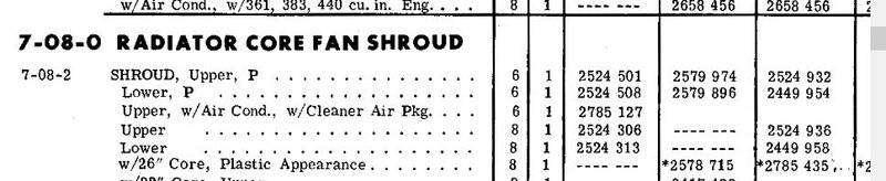

So was the cooler on the radiator completely bypassed? Or was the radiator for the Hemi cars not equipped with the cooler? Someone here also stated that the fan shroud for 1966 was a one year only. Is anyone aware of a reproduction fan shroud for 1966?

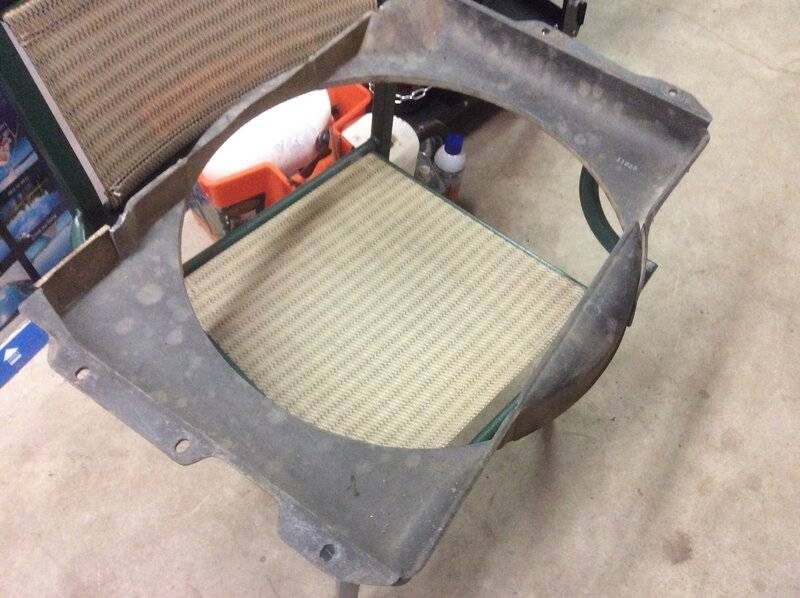

Lines routed through trans then to external cooler then back to trans. They sell the lines repo. Fan shroud has a steel access plate. Any A/C car with a 26" radiator.

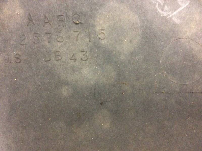

Shroud on mine is the same one used up thru 1969.and last i ckd was still avail thru and mopar dealers
66 parts catalog bottom of picture middle column b-body column.
