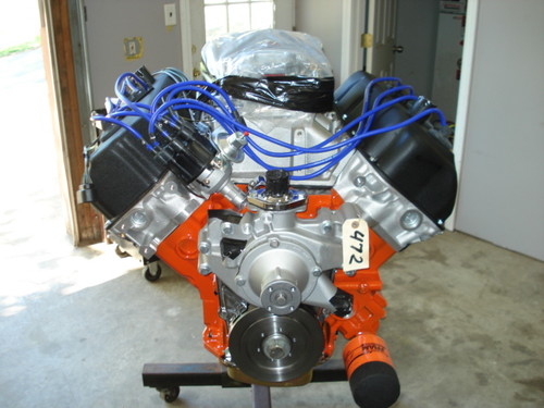

Wow does this sound familiar! Sorry to hear someone else had a similar experience to mine. I purchased a 472 from Gozzymopar last summer and had similar results.
I called from the E-Bay listing and Jim told me that instead of buying it through E-Bay he would supply a quote and I would need to send a check in full to order the engine. No negative E-Bay feedback or Paypal dispute when it's done that way! I did ask about a few different options on the build and had to postpone my order for about 3 weeks due to an issue with the sale of my Harley after which Jim did honor his quote.
When the engine arrived, I had planned to use my own oil pan and intake, when I took the ones off that the engine that came with it along with the incorrect valvecovers, I also found metal grit and list of other concerns inside:
Scat connecting rods w/8740 bolts (not Eagle rods w/2000 ARP bolts as stated in E-bay listing and my quote)
No roller rockers as stated on build contract and in a phone conversation with Jim- When I pointed this out, I was told it was a mistake on the quote and I could have them for another $1100.
Pushrods were no where close to centered in the head holes
Grade 5 bolts in rocker stand assemblies
Large visible casting flaw in top of right side middle rocker stand
Standard Pioneer freeze plugs in block (not stainless or brass as stated in build contract)
Standard grade 5 bolts on cam gear (not ARP as stated in E-bay listing)
No oil slinger on crank
No splash shield on bottom of intake
Standard type water pump- not hi flow
Sealing washers left on sparkplugs, damaging sealing surface on tubes
Only single VC breather- E-bay pictures show dual breathers (Jim offered to sell me another one)
Engine not painted as outlined on contract
Incorrect valvecovers- were supposed to be chrome, I received black.
Didn't send the electronic ignition kit, had to debate on whether it was shipped or not. He did finally send it and paint to finish the painting the engine.
When I found that there were number of discrepancies from the quote/E-Bay listing and contacted Jim on multiple occasions the response was less than impressive. I was told that my engine had nothing to do what was in the E-Bay listing. Unfortunately, Gozzymopar is too far way to have returned the motor so basically I ended up with a bunch of parts and the additional time and money invested to make it right.
I can only say Caveat Emptor!
