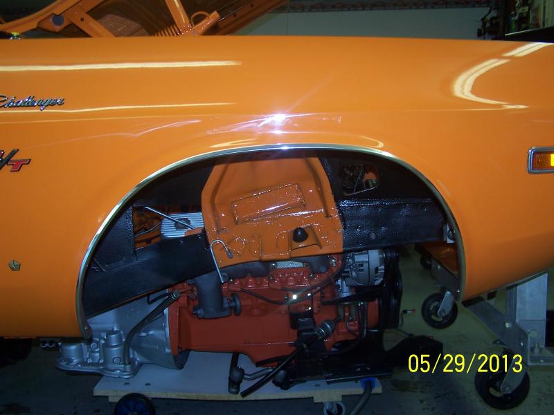

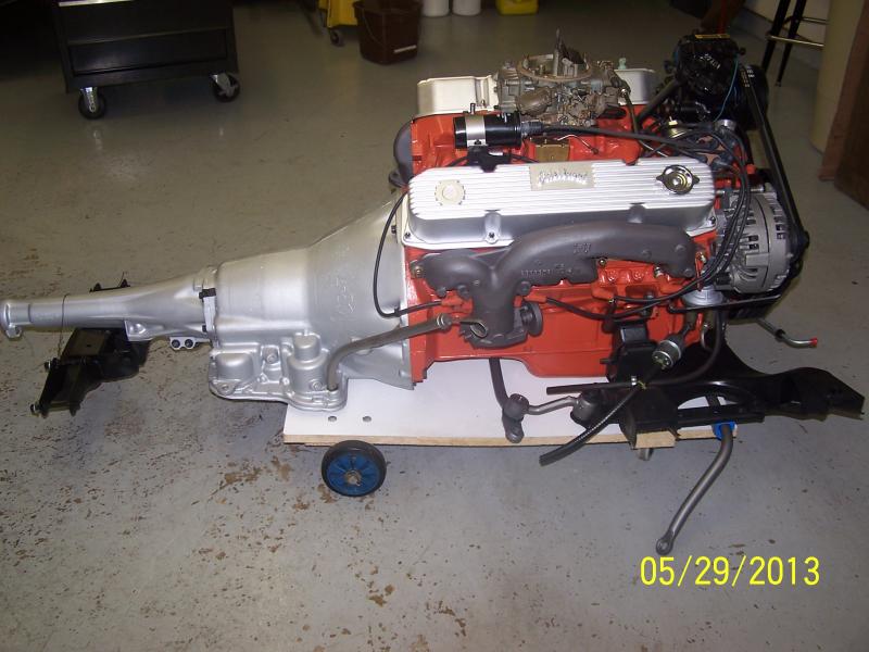

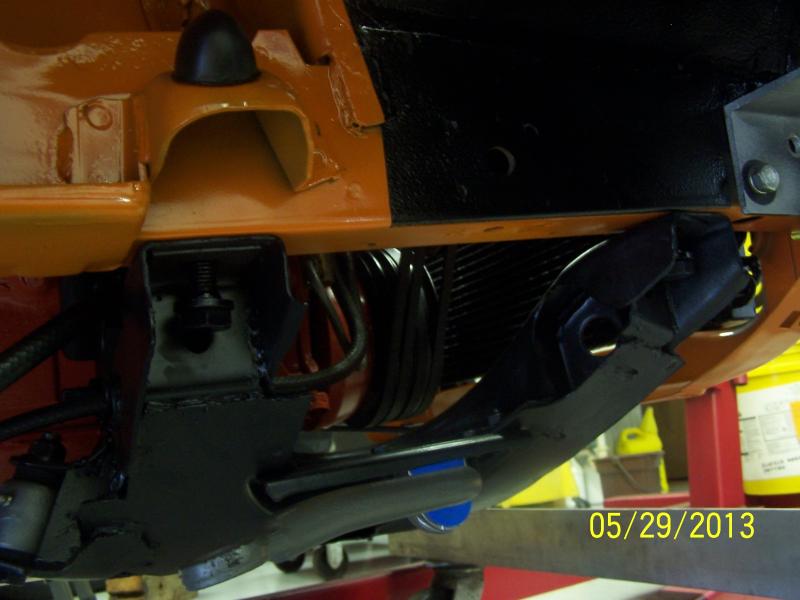

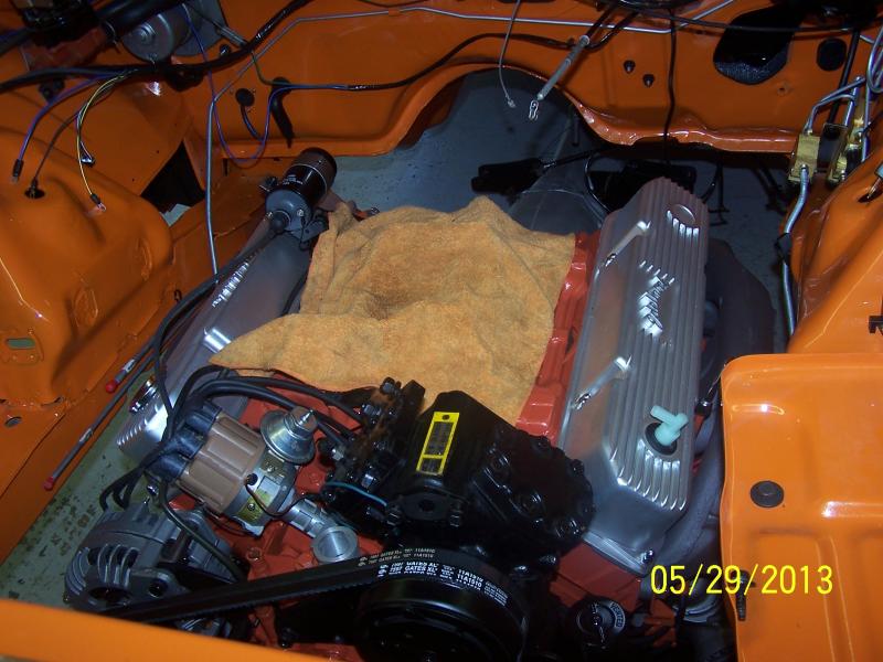

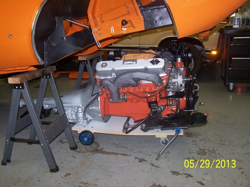

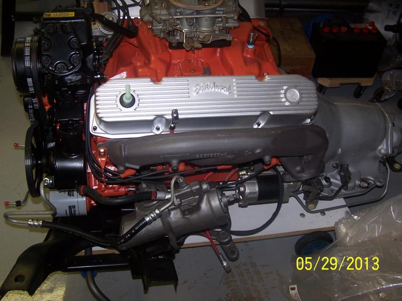

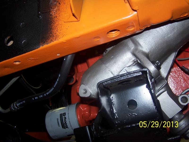

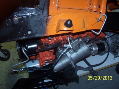

Here are some pics of how I did the install in a 70 Challenger
Sixpactogo
8:36 AM
Feb 2, 2014
2,506
2,847
Eau Claire, WI
I fabricated a platform on casters. Raised the body high enough to roll the unit under the car, then lowered the body down onto unit. I only have an 8' ceiling in my shop so could not raise the body much higher.

What did you use to raise and lower the body?
I used my cherry picker to lift it to the required hight and had to use the saw horses to enable removing my cherry picker so I had room to roll the cart under the body.
Then re-rigged the cherry picker so I could lower the body onto the K frame for bolt up. Then I put my floor jack under the tail of the transmission to jack it up into place.
It took about 20 minutes to complete the bolt up and was much easier than going in from the top. No scratched paint either.

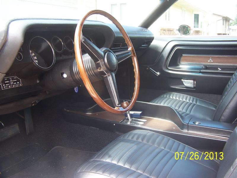

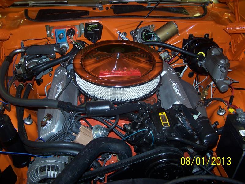

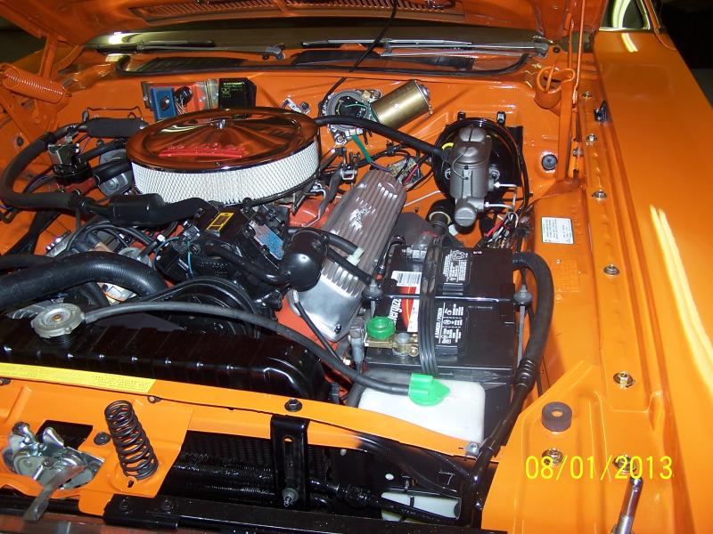

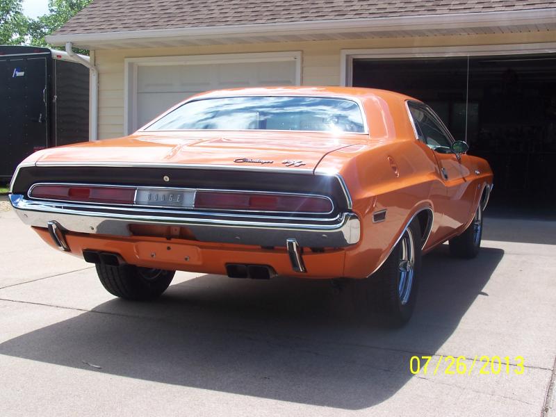

The car was finished last year. Here are some pics of the finished product. It belongs to my Niece and is back in the St Louis area100_5672.jpg100_5671.jpg100_5652.jpg100_5651.jpg100_5650.jpg100_5660.jpg100_5658.jpg100_5653.jpg
