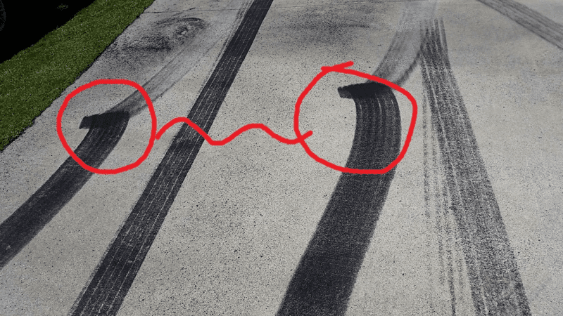

How do I know if open or sure grip?
Glad you asked....I conducted this very experiment on my buddy's driveway a while ago...
Suregrip marks.....
and a Pegger......
Hopefully that concludes today's lesson. :D

Bad sport is mostly right, but you don't multiply by two with a suregrip. Any limited slip diff will act like a spool if it's any good at all, if the tires are in the air, so simple observation of the number of turns is correct.
If an open rear end, with one tire on the ground you must change the number of turns because of side gears and spider gears in the diff. It's easier just to jack up both, then they will both rotate (in opposite directions) and again count turns of the driveshaft for one turn of either tire.
OR you look for a tag on the mounting nuts of the third member....OR remove it to know for sure.
