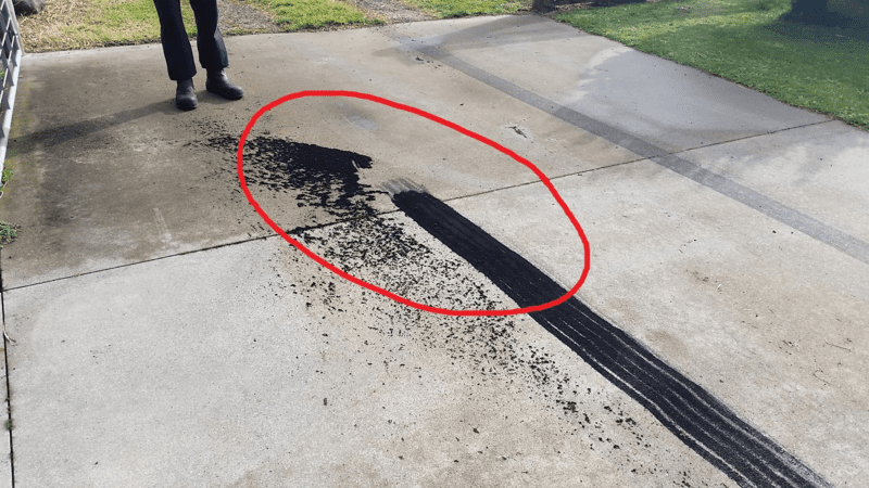

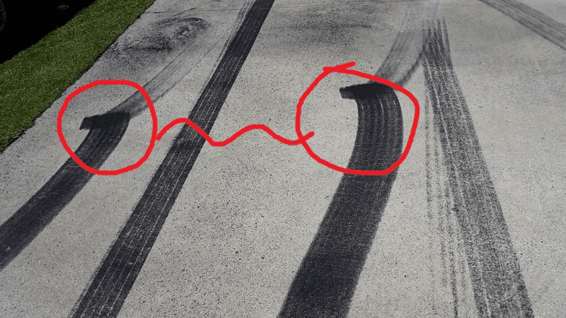

                Jesus Chrysler this is painful. Like described, plant your right foot and count the streaks. Don’t like laying under the car with a crayon, etc. i have never known or cared about offset or tire diameter. Put a Tremec in and be done with it. 1935 @ 65 w/SST.
