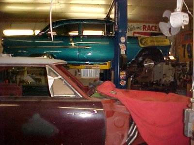

Have the Challenger Versemetric Lift here, in service for 13yrs. You can see in the pics that there is a two foot extension on it. This allows full stand up access under tall vehicles like some camper vans and work trucks. My ceiling height is 14ft 2in. I have just about 2in clearance above the posts. I got a great deal on it because I helped the guy install it.

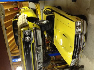

I have an Atlas lift that is a combination lift (from Greg Smith equipment). It works as both a symmetric and asymmetric lift. I have had it about 2 years and I am really happy with it. My garage with the lift is a one car bay that is 15 x 33, in other words long and narrow. I am able to change how I put cars on the lift based on what I need to do. Since I also put two cars in the bay, I often back a car on to the lift. At that point I use it like a symmetric lift. At any rate, it gives me great flexibility to do both.
(not sure what happened to the picture upload, it was correct when I uploaded it. Now you get a chance to stretch your neck!!! :icon_fU:)
might want to move the drip blanky to the car on the bottom.
:icon_fU:
lol!
Nice lift, I was looking at the atlas stuff earlier today.
:icon_fU:
lol!
If you look closely, you can see a piece of metal roofing under the 70. It is a cheap and easy way to add a "drip blanket". I hold it up with two furring strips. So far it has worked great. The only problem would be if I had a brake leak. So far I have been lucky.
The top blanket is when I am in the doghouse and have to sleep out there!!! :black_eye:
