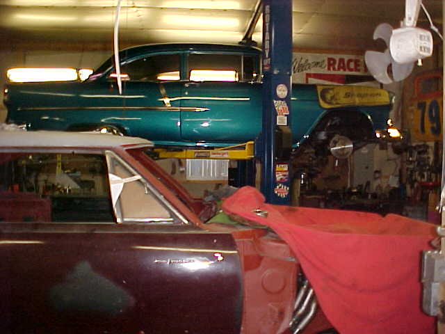

ROTORY !! In my mind the best on the market !! I have there 9000 asymmetric and LOVE it ! Had three diferent brands at my shop when I was self employed till I got a Rotory. Thay cost alittle more than some but Hay your standing under it ! How much would you pay to get killed !?!?!
The asymmetric is nice for redoing older cars as it lets you hang the door all the way open Plus gives you more options on position.
I have been under ALOT of lifts in my 50+ years and I realy like this lift !

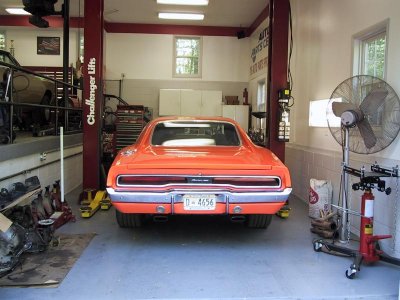

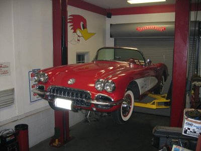

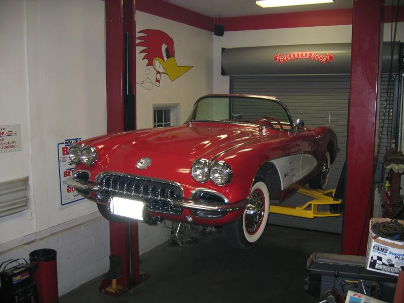

Have the Challenger Versemetric Lift here, in service for 13yrs. You can see in the pics that there is a two foot extension on it. This allows full stand up access under tall vehicles like some camper vans and work trucks. My ceiling height is 14ft 2in. I have just about 2in clearance above the posts. I got a great deal on it because I helped the guy install it.

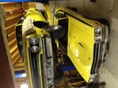

I have an Atlas lift that is a combination lift (from Greg Smith equipment). It works as both a symmetric and asymmetric lift. I have had it about 2 years and I am really happy with it. My garage with the lift is a one car bay that is 15 x 33, in other words long and narrow. I am able to change how I put cars on the lift based on what I need to do. Since I also put two cars in the bay, I often back a car on to the lift. At that point I use it like a symmetric lift. At any rate, it gives me great flexibility to do both.
(not sure what happened to the picture upload, it was correct when I uploaded it. Now you get a chance to stretch your neck!!! :icon_fU:)

If you look closely, you can see a piece of metal roofing under the 70. It is a cheap and easy way to add a "drip blanket". I hold it up with two furring strips. So far it has worked great. The only problem would be if I had a brake leak. So far I have been lucky.
