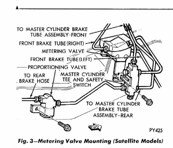

I am in the process of converting my roadrunner from drums to front disc/ rear drums. They are manual brakes. I Just bought a prop valve and hold off valve from inline tube. They could not tell me how to install it or offer any suggestions. I have a metering block now that is along the frame, under the master cylinder. My question is: how the hell does this thing plumb up? Prop valve looks pretty self explanatory but hold off valve (3 port) is attached to the prop valve and not marked. Any help or tips would be much appreciated. I cant post pics but if you pm me than I will email them to you. Thanks a million!

This is the 1970 setup, don't know what year yours is.

Thank you. I have a manual for it but it does not have that illustration. The confusion on my part comes from the fact that I am using a combination valve ( inline tube) and the metering block that bolts onto the combination valve. This eliminates the deprecate prop valve ( I think) and I don't know how to plumb it. Does it plumb the same as that pic minus the prop valve?

The one with 3 ports (top of diagram metering valve) splits off to the 2 front calipers from the safety tee.
The proportioning valve (hold off as some call it) goes to rear drums and once it reaches a certain pressure it stops the flow to the rear (hold off) and the front continue to work harder as you brake harder.
I know newer systems incorporated the proportioning valve into the safety switch tee, if you have that type of tee you don't need the separate valve going to the rear

1969 . The part numbers are blk246 and blk247. I called inline tube and they could not offer me any assistance. I am going to plumb it according to 440+6's diagram. I think it is spot on. I sent the pic to inline tube and they said it appears to be correct. They also stated that they will save the pic for future uses! Thanks for the assistance
