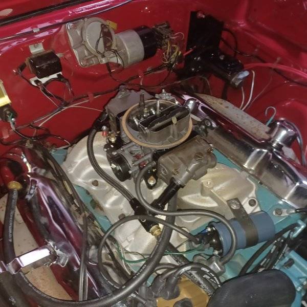

So now that all you smart folks have got me on the right track, I will be getting rid of my Holley. The numbers on the air horn were VERY faint and seemed slightly double stamped, but under a magnifier was 76750-2 and 3325. Probably means it is a 750 double pumper, but I can't find this model and list number anywhere on the internet. Maybe there is a secret decoder somewhere? Any ideas? Looks like close to brand new condition, would it bring $400?
I just sold an AED 850 or 950 couldn't tell which one it was for 300.00 But it came off of a crate 502 Big block chevy.. So it had to be either one of those.
Ultra double pumper, billet metering blocks... made in the fall of 2005?? List number #76750-2 is not difficult to find.
