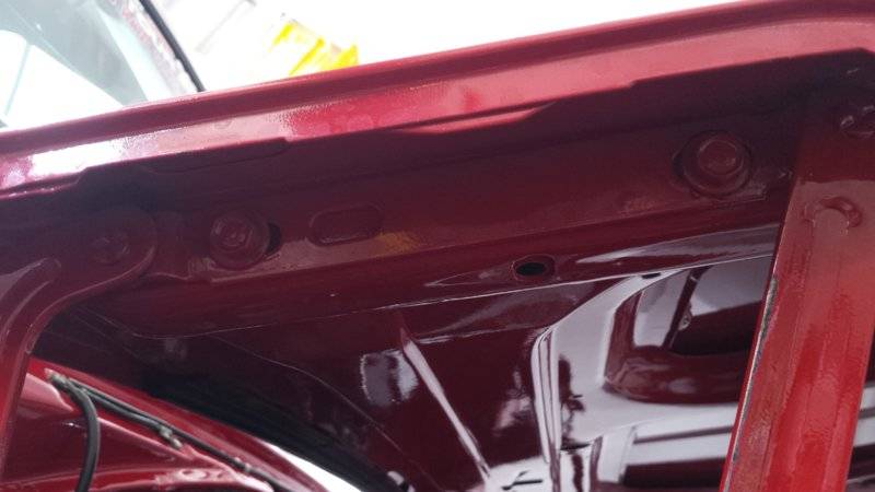

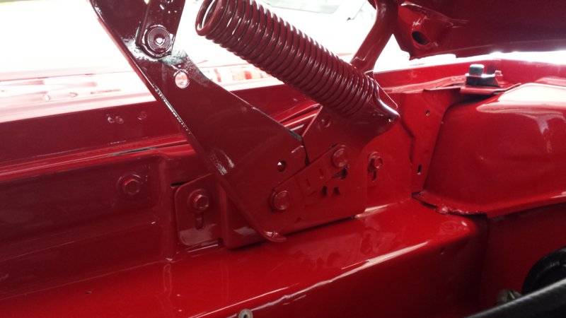

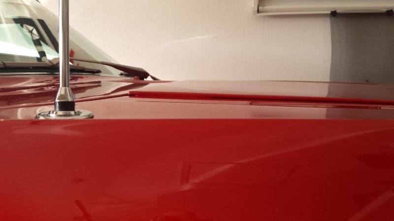

A hood hinge broke a few months ago on my '68 Coronet. I bought two new ones and had them painted. With the adjustments all the way down, the back of the hood sits exactly 1/4" above the cowl and fenders on both sides. Is this common? Is there a way to lower it further? I thought of lengthening the slots, but the bottom of the hinge is right at the top of the radius of the inner fender.

Maybe try moving the rear of the hinge down and the front of the hinge up? Think I had that issue once.
No that is not normal. As DC said above the front needs to move up.....
