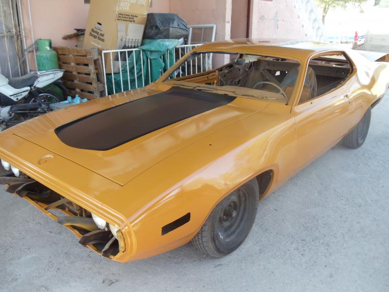

Noticed this on my parents new '71 RR back in the day and currently on my '72 SSP project car, at certain speeds/highway road conditions the hood starts to shake/vibrate a little left and right (when closed obviously). I was just wondering if this will be a constant "defect" or if anyone has eliminated it completely by balancing the front tires, rebuilding the front suspension, wheel alignments, etc. ?

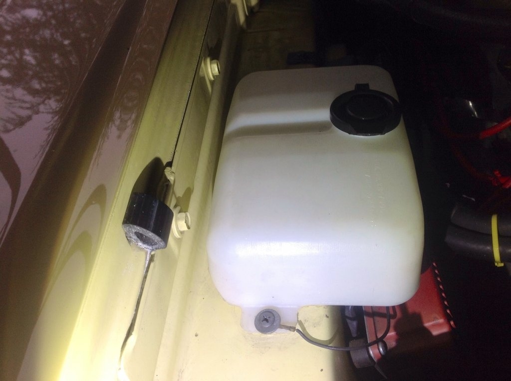

Hood movement relative the fenders is controlled by the spring loaded wedges in the rear and the rubber wedges toward the front. If these are not in place and/or functional there will be excessive movement relative the fenders. If the hood to fender gaps are too wide, the wedges will not be effective. Fact remains there was a design change for this body platform beginning in ’72 adding cross bracing to the front fenders with some engine combinations to control lateral movement of the fenders and hood. As with any other production design change, the expense (however small) to make this change would not have been undertaken if a problem wasn’t perceived to exist. The struts were carried forward during the following model years.

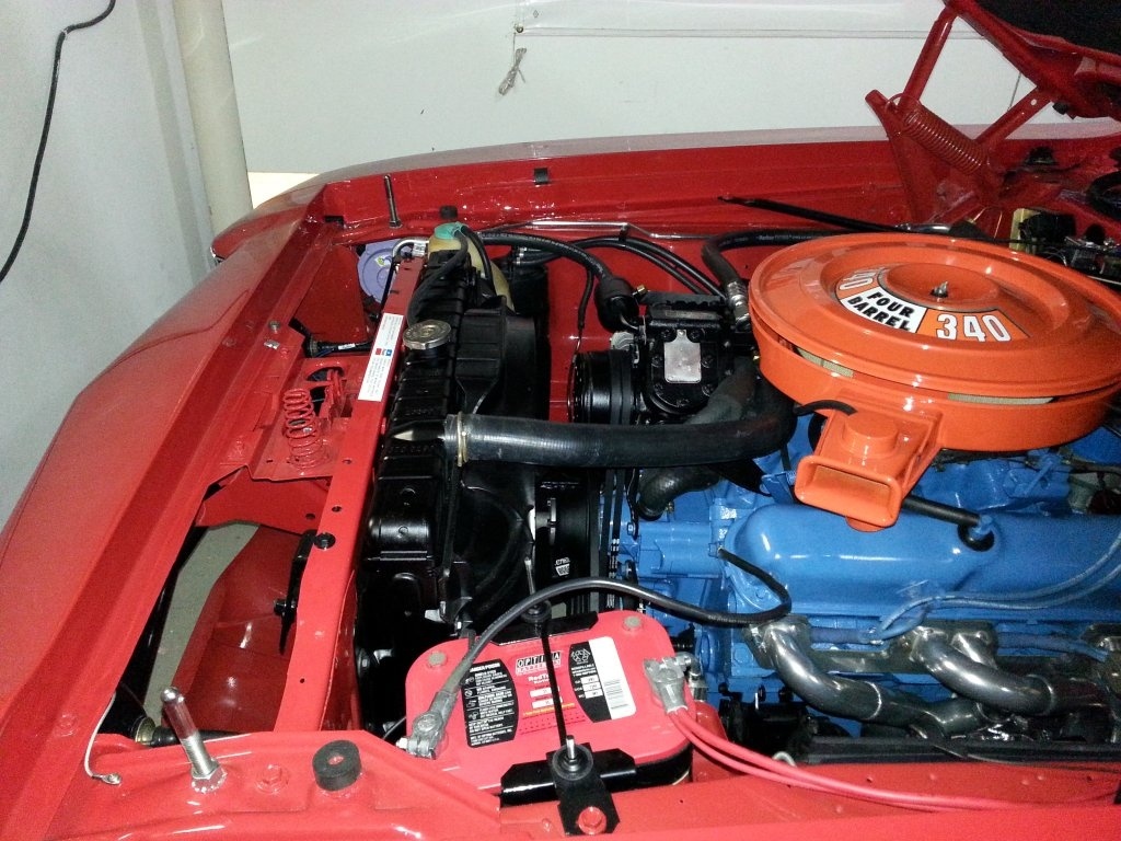

No Shimmy ever on my car, small block with strut rods, and the rubber bumper on the front location of the fender and the spring loaded one on the rear of the fender. This side view shows both, the spring loaded one is visible just behind the hood hinge.
