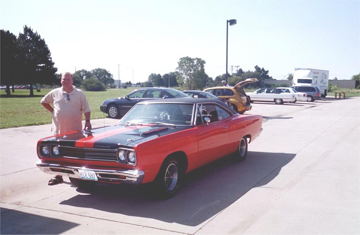

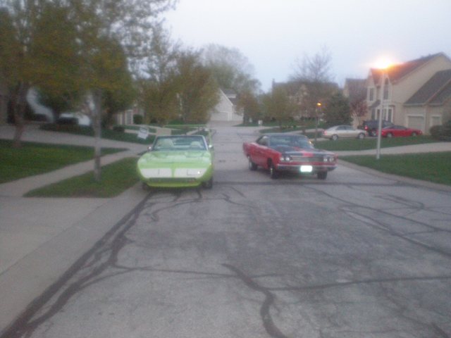

i did mine in the orginal matte finish the first time and hated it , they get wax in them and are totally a pain to take care of , So in the second restoration go around I made them gloss black & cleared them , they are not stock but they look great and are easy to care for . My 2 cents
i agree with stuart unless you need to have the 100 percent orig. resto i would go with the cleared stripes easier to take care of and still looks great.
