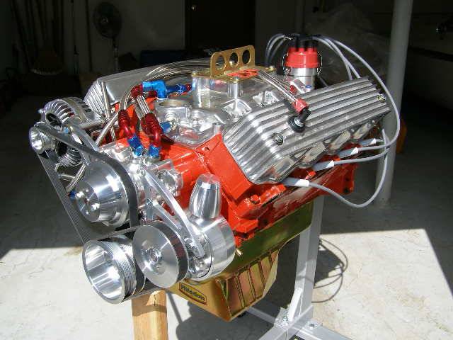

I think the 361 4-barrel motors had 10.0 : 1 compression, but they are likely quite rare. They were the standard motor on 1962 Polara 500's. After Mopar started putting 383's in B-bodies, I think 361's came only as low compression 2-barrel motors. A good closed chamber head that would keep compression up would be the big valve/port "915" heads that came on 1967 440 Magnum engines. Again, these are getting hard to find. That 2 X 4 intake from a 350 will bolt right on a 361, just don't try to run too big carbs. Something like Edelbrock 500's would be good. The factory setups ran about 1/2" spacer under the carbs to keep throttle linkage from hitting intake runners. Classic Industries sells a repro carb linkage/kickdown bracket for 2 X 4 setup. The repro RoadRunner cam would be good at around .470" lift and 280 degree duration, with a nice rumble. Smaller motors like a 361 don't need as much cam as a 440. A 361 (and 383 and 400, for that matter) has a shorter stroke than a 350 Chev and will really rev with the proper breathing system.
My vote would be for the 2 X 4 intake, just because it is nice eye candy. I ran one on a 426 Street Wedge in a 1964 Polara 500 convertible I had. Whenever I opened the hood, it drew a crowd. I found a guy in Arizona or New Mexico that reproduced the "Football" air cleaners in fiberglass. Good luck with your project.

Other than the Cool Factor the dual quad intake is very unnecessary. They and the oval air cleaners are a good look though.

thanks .... nice drop top. and ya i was retinking the cam .... i think the ol purple shaft 292 mite be a bit much ... will sound good but. i have the spacers for the carbs. but thay like an inch thick someone may have swaped them out. thay are plastic-ish thing. and a 361 could be had as a HP i think it came in at 330 horse. im sure some one will correct me if im wrong. i have a bunch of AMC stuff and have 3 old carters from a 343. i think thay were 475-ish. that should work with what im planning. .... thanks for the input tho. always good to get a second look at things

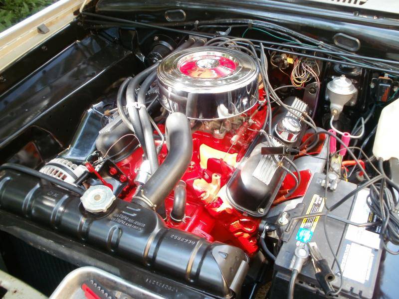

ya ... i don't think it makes that much if any more power on a mild mill. but kinda going with what i got laying around. and the cool factor is just that .... and as ya can see from my under hood pic. im into the stock-ish look. btw .. thats a 68 X head 340 under all that 273 bling. :thumbsup:

I have been on the lookout for a 64 Dodge and wouldn't mind a 273. I would dress it up Charger style. I think I have all the pieces. A Poly would be just fine as well.

i like poly's ... made good power good on gas. i had one in a 59 dodge 100 2 wheel drive with the farm box... she would pull anything and still cruz at 70-75 with no hint of being upset about it..... maw mopar realy should have stayed with that program a bit longer .... jmo
