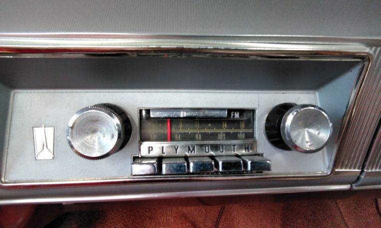

Swapping in a year-correct AM/FM to the ‘64 Sport Fury and it’s occurring to me that I can’t remember many of these at all. How common were they 1/50?

Not to highjack the thread, but keep in mind the early Bendix AM FM radios did not perform well on FM. These radios were AM chassis kludge with a FM sub PCB and tuner. Sensitivity was poor and the always ON AFC makes them temperamental to tune.
I recommend keeping the great performing AM radio and adding a Redi Rad for modern connectivity. You don't get stereo with those old AM FM radios anyhow, so just add the Redi Rad and keep it simple.

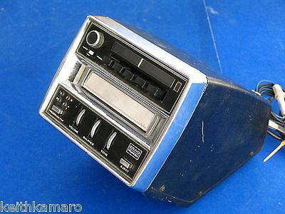

I sold a lot of those at the parts store. My 8 track players had FM in it. Rarely did I use the factory AM radio when you have Doobie Brothers on 8 track! Craig Powerplay rules!

That is a pretty rare piece, likely due to the fact that there were not a lot of FM stations to listen to back in 1964. Note that that the radio bezel is not only specific to Plymouth, but also to the AM/FM radio, in that the controls were offset. When I was restoring my '64 Polara 500 convertible, I saw the Dodge version at Carlisle likely 20 years ago. It was $$$ back then. I ultimately cheated and put in an AM/FM. from a Dart that fit my radio opening.
