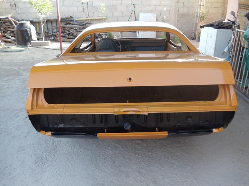

How does one move the decklid (trunk) over a little to the left (passenger side)?

How does one move the decklid (trunk) over a little to the right (passenger side)?
On '72 Satellite Sebring Plus it is obvious how to move the trunk forward or backward, but i can't seem to move it side to side. What is the trick? Thank you.

I am not 100% sure but I dont think there slotted side to side. They are not on my 68. There was a enough play to center my deck lid.
We've just pushed the decklid sideways, if the rest is aligned. Kinda give the hinges a little persuasion.
check and make sure your striker and latch is not pulling it to one side more than the other,
also ck your front edge gap, if it seems tight on one side , loosen just that side that is close on the front and adjust it back a hair.
that will close up the gap some on the other side.
