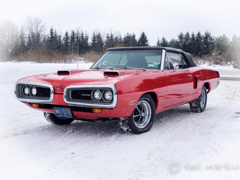

This is one of the cars I did in my garage last year....
Before:
After paint:
And here's one I did this year....
Before:
After:
And the build thread here has some info on it including bodywork, and paint info: http://www.forbbodiesonly.com/moparforum/showthread.php?81535-She-s-a-keeper!-72-Plymouth

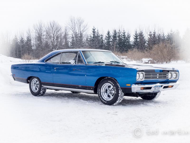

And here's another one I built this year.
The only single stage paint that is OK by me is the satin or flat colors like this
I hope that gives you some ideas and helps. WATCH THOSE VIDS! DIYautoschool and SWRNC - It's a great place to start.
Good luck to you. If you want to, any of you guys can message me for info. I'll do my best to help.
