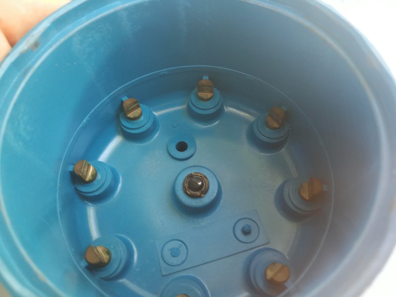

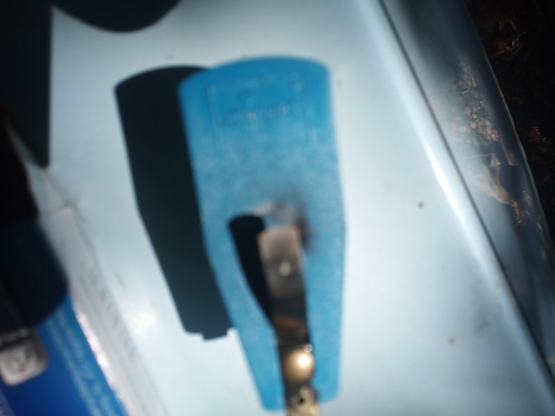

HI,
I think I fixed it....:) runs much better not really missing but still has a strange note on the driver side exhaust. Changed the cap and rotor I have 8mm wires on order (Summit ). Didn't see any problems but the rotor pin looked funky. and the rotor did have some flash marks around where the button touches the tab. See pic.
Thanks take care be safe
tim
HI
Took it for a drive and blew the cobwebs/carbon out of it and It runs 100% better. going to have to idle it down and readjust the mixture's now from adjusting it while it wasn't running right.. Must have been the cap and rotor all the time...

You have me thinking of the Same problem I am having now with the summer heat. My cap and rotor look the same. I would guess the high heat could be relaxing the pickup just enough to create a gap between the rotor and cap pin causing an arc and the carbon flash we are seeing on the rotor.
Just a guess but a simple fix.
