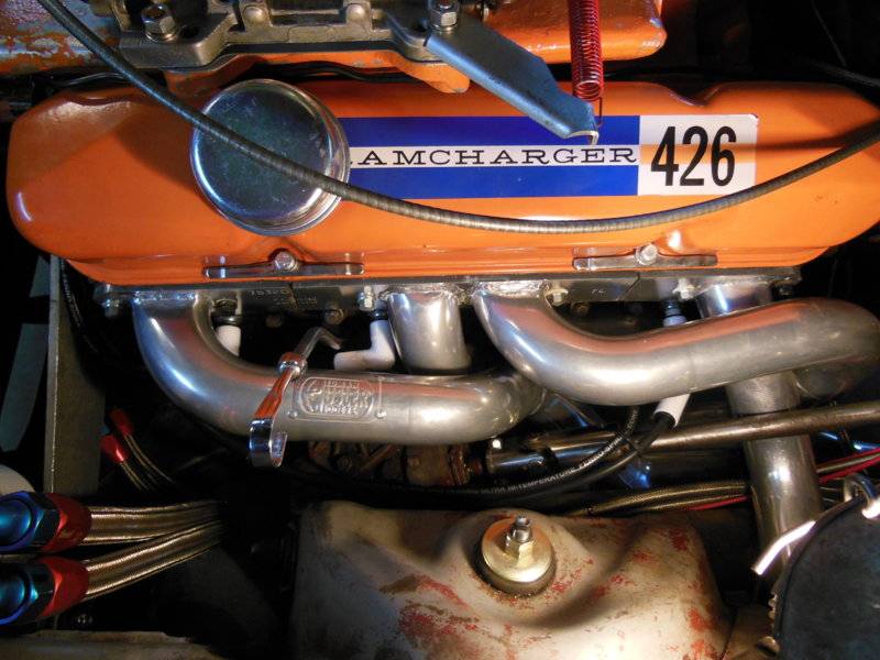

I went thru th
e same thing with these stage 2 max heads..i took a set of moroso 93055's and cut off the xtra 2 holes and used sealer..1 I had to do twice..and used hold down extension's on the lower bolts..
I see cometic is making VC gaskets with 2 beads of silicone all the way around..wonder how they would do on these OEM heads with natural unmachined sealing edge..

View attachment 586463 View attachment 586463 I went thru thView attachment 586462 e same thing with these stage 2 max heads..i took a set of moroso 93055's and cut off the xtra 2 holes and used sealer..1 I had to do twice..and used hold down extension's on the lower bolts..
https://www.summitracing.com/parts/cgt-c5983
I believe the Cometics, like the SBCs are being made to seal on the flat, wide rails of aluminum heads. I see we both fabbed similar hold-down spreaders...great minds think alike. lol
