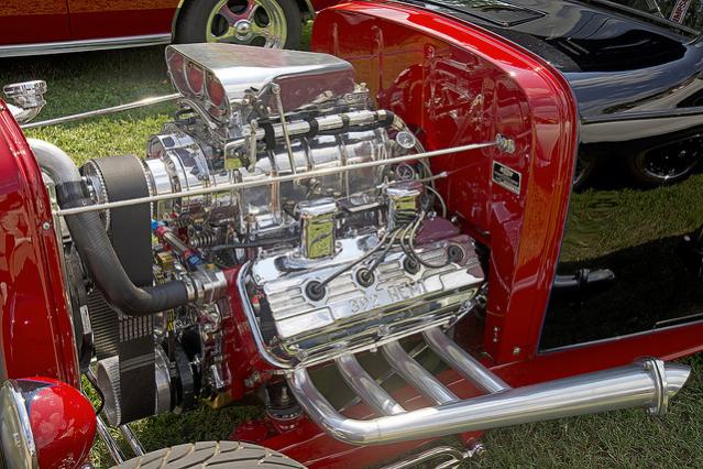

I also find it interesting that a favorable and relatively easy to obtain stroker ratio on a 318 gets you 392, a number that keeps cropping up in Mopar performance engines.
......and has for quite some time.
Like the original poster asked,"What can I do with a 318?".I answered.If you don't like a bunch of stroke in it then that's fine.But that is one thing you can do with it.Same guy ran a 360 crank in a 318 before going with a 4".Same difference right?I may be wrong,but I don't believe he ever asked "What can I do with a 318 and the stock crank?".You can do anything to that block you can do to a 340 or 360.Just depends on personal preference and how far you want to go.

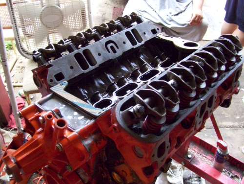

Rob I agree but I am not stroking my 360 it's almost done. Now my 318 in my Doba that everyone hates it will be rebuilt but with good parts and heads. No stroker engine. Now to find some 273 rods on the cheap.
Are you talkin about the 273 rods for your 360? That would be a snappy choice.....but you will probably have the expense of balancing if you were not going to do it anyway. Just food for thought.
No for my 318. But if I need to rebuild it sounds like it might be a good choice. Here is a picture of my 360 refresh not rebuild.
