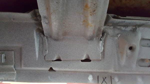

how the factory welded ?
Here's the opposite end of the rail I posted earlier. I'd say it was a two man job, sober worker on one end, after lunch buzz on the other!
That's a huge difference.
