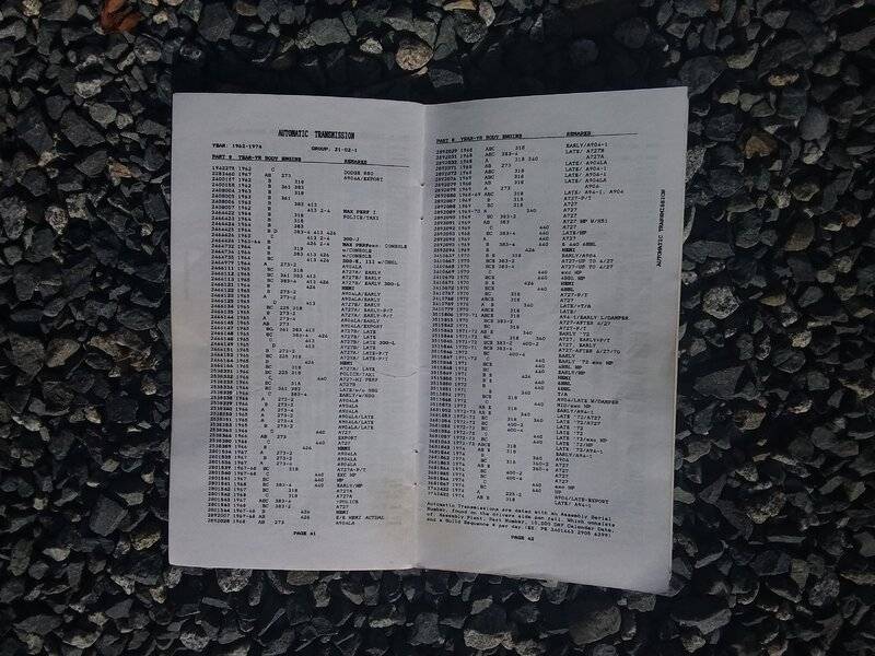

Here's one, not sure where y'all are finding the info.
PK3681866 4484 0706
and
23?2090L 2741 6315
2892090, which yours could be, is a 1969 383 2bbl 727. A half stamped 8 could look like a 3
look for a white book named chrysler corporation part and casting numbers.it may still be in print. mine is old, but it gets the job done.
Any clues on the 2nd one from 1969?
10,000 date code 2741 shows Jan 28th 1969 for the trans # 2892090
Sorry, didn't work well
I had no issues using it. To be sure I would then also back track thru all the blue mopar parts books from 62-70 I have in order to verify accuracy of the books numbers when needed,,,,The book was accurate,,,Sorry.
