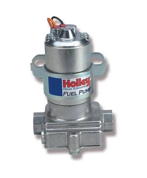

on my satellite i have a holley fuel pump (electrical) since i will be changing my engine soon the engine builder told me i would need at least 110gph fuel pump but i have no idea the model since it was installed by a previous owner
is there a way to know the GPH of the fuel pump ? i was thinking of unhooking the fuel line and have the pump run for 1 min then multiplie the volume by 60s in a gas cannister but i m not sure it s the proper way to do it

the holley label is in blue so i supposed it a 110gph but without having to remove the pump is there a way to see the reference. i have no idea how old the pump is
I have a old red that's labeled as a 110.....

Look up the part number on the pump. If it’s Holley blue then it’s 110
Remove pump. Put 5 gallons of gas in a can tilt so you have a low point. Use tube size your using time how long it take to pump can dry. should take 9 mins and 10 to 15 seconds for a 110 gph pump. Check my math.

I have 6 of the older Holley pumps....2 are red and 6 are blue. 1 red pump has a sticker that says 110 gph and 2 of the blue pumps also have that same sticker. 2 pumps have numbers (1 red and 1 blue) on the bottom plate and both are different...and both of those do not show gph on the sticker. ALL of the pumps have a number on the bottom side of the inlet port and all of them are the same number. I'm more cornfused now than before I saw this thread lol!
you see why i was asking
when i saw the blue sticker on the pump i though yeah cool 110gph
i tried unplugging the fuel hose coming out of the pump and seeing how much gaz would flow in a cannister for 1 min but it just didnt send enought gas to make it a 110gph
