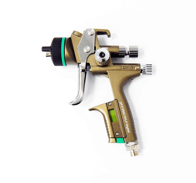

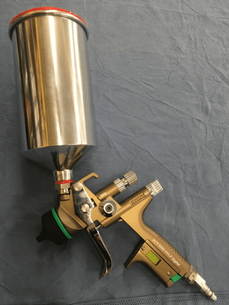

Got me a new toy the other day.......used my buddies and just had to splurge! Thing lays paint like a dream!
My C.A.T. gun came with both HVLP and Compliant (reduced pressure) tips. I like the compliant version more than the HVLP. A bit easier on the compressor too.
That isn't cheap!!
No but I figure it'll last me a lifetime as I do one car every 3 years or so. The compliant gun made a bit more overspray so I went with this as both sprayed awesome and I just do it in my garage so less overspray is better. My Iwata LPH400 must be the slowest gun I have ever sprayed with and this was lightyears faster when I tried my buddies which is my style. No more struggling for me with this gun! Got the 1.4 tip in the "O" pattern.
Thats awesome, I paint about the same amount of cars you do and I have a variety of HVLP guns with the best being the Devilbiss finish line. I have thought many times about getting a really "good" gun but just never have.
