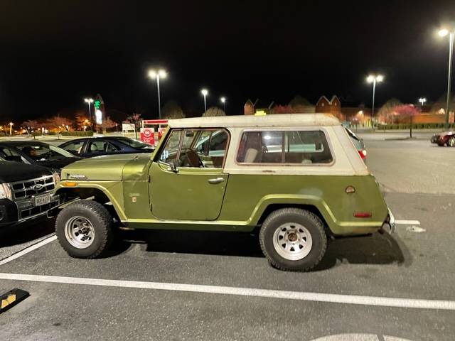

I am rapidly moving to having my 71 Jeepster Commando as my daily driver. Mostly for the reasons above and the like. The oil filter in my Jeep Liberty is a colossal PITA to get to. To do plugs, I have to pull the fuel rails. I have a company truck, so daily driver means something different for me than most.
