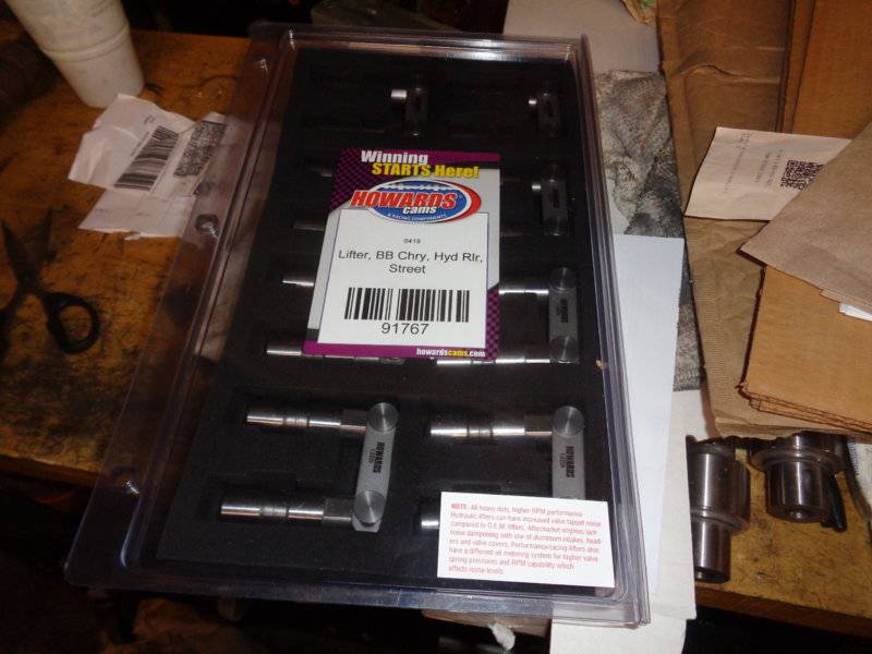

Morel Street series lifters(recommend 350-375 open pressure), high lift/high rpm lobes, dual springs set up at 140/370, RAS 1.5 rockers, Ede heads.
No audible valvetrain issues, and power still hanging on good at 5800.
Make a pull to 6000 see what happens....... power still looked decent.
Make a second pull to 6000........ motor is skipping after the pull.
One plunger is stuck at the bottom of a lifter.
Had to replace it.
Driven 10/40 oil.
We don’t really blame the lifters...... just seems to be the nature of the beast.
Dynoed another 446 a few months ago......same lifters, same springs, Crane ductile 1.5’s.
Limited the pulls to 5800...... no problems.
