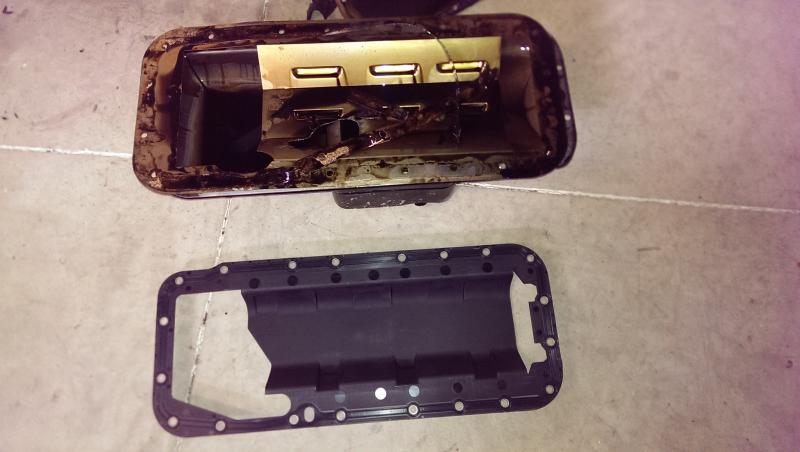

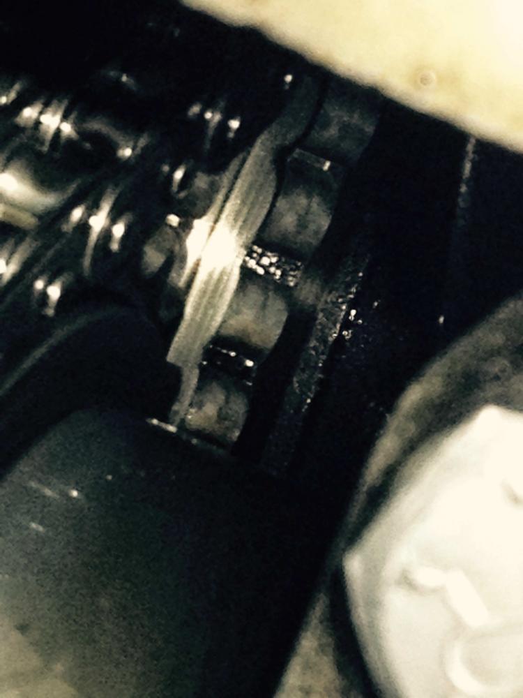

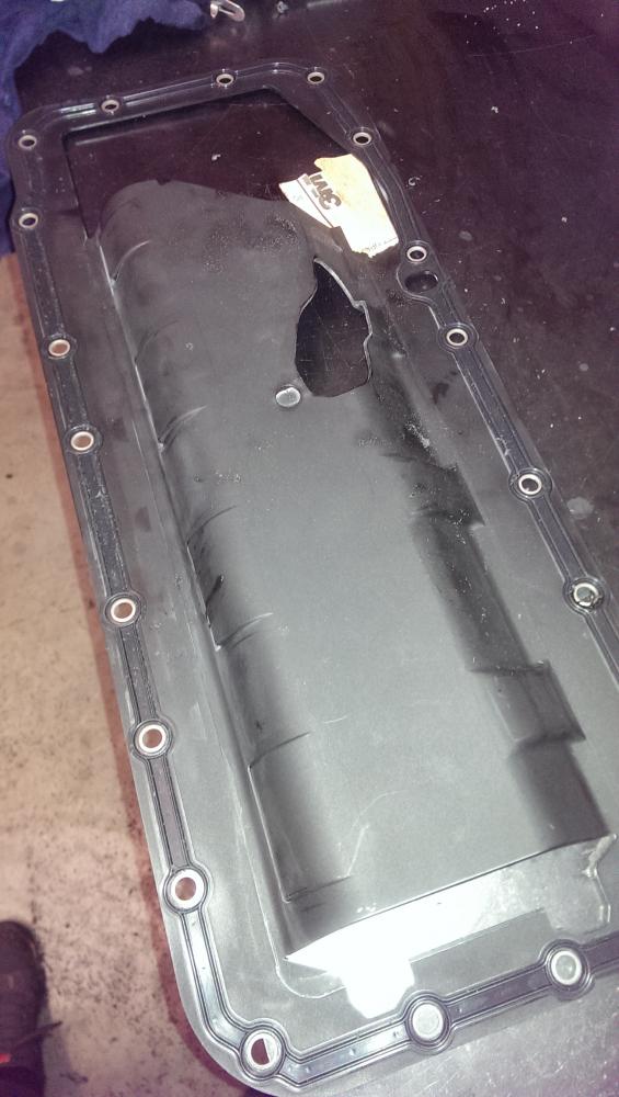

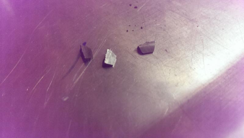

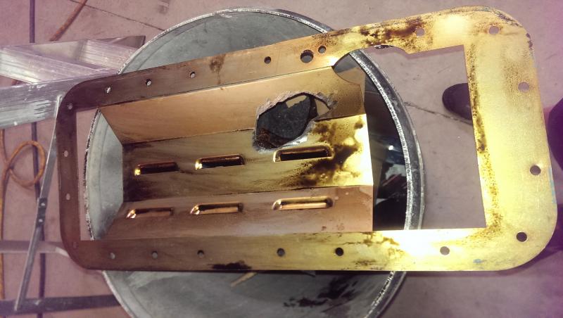

Pulled the oil pan to replace the windage tray and cork gasket with the one piece summit tray and found a few little teeth in the bottom of the pan. Took a closer look and they're from the timing gear. No real idea what would cause this I've been in touch with CME and it sounds like they'll send a new gear and chain but I definitely find this odd... the only thing that stands out is potentially a defective part to begin with.
Had to notch a bit out of the new tray to clear the oil pick-up as was done on the old tray. New tray was also about 1/4" more shallow.

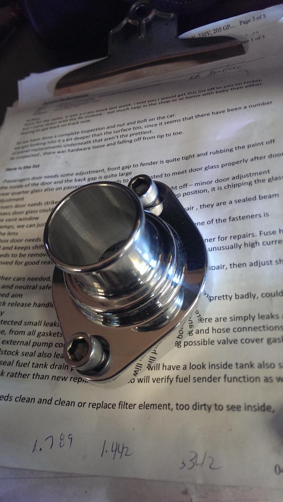

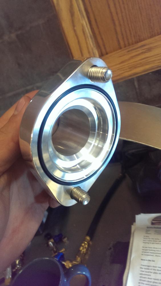

Got the new billet water neck with O-ring seal installed to replace my leaky chrome POS

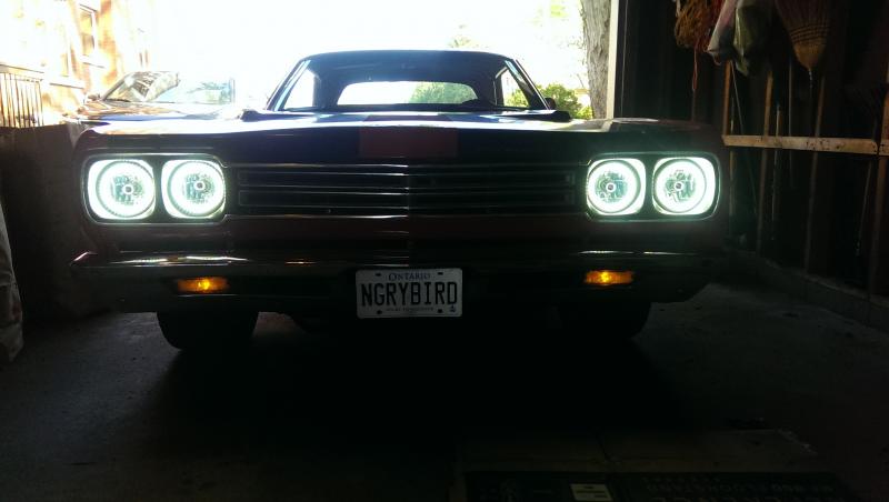

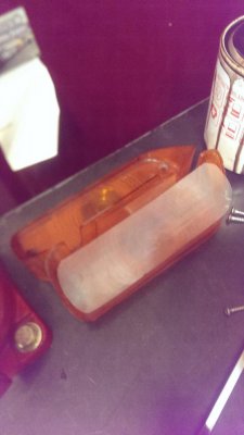

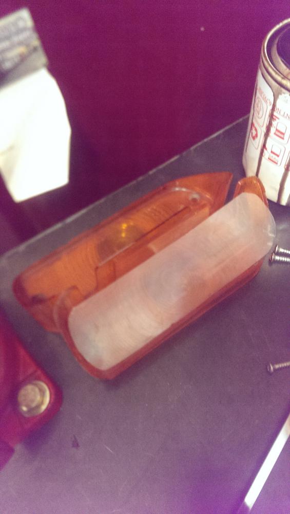

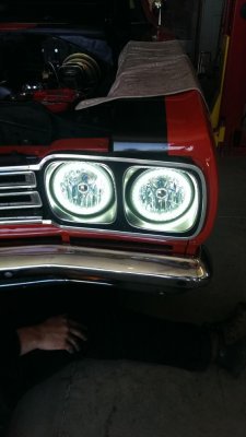

working on an issue with my parking lights since I installed LED and my mechanic made a cool suggestion that he's done in the past to magnify the brightness of LED's but at the same time take away from the effect of seeing each individual bulb by cutting a piece of a diffuser. The piece i cut/used was the same as would be layered into a laptop screen.

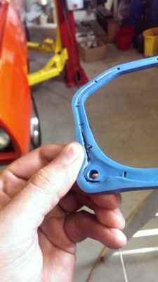

My silicone "re-usable" valve cover gaskets both had a split in them so those both need to be replaced as I was getting some leaking again on both sides and I found a split starting in the sway bar mount that will get welded up tomorrow a.m.

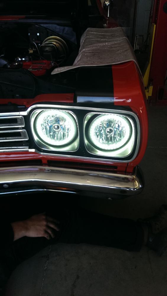

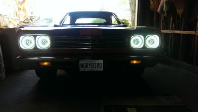

Aside from that when I left today he was going to make a harness for the LED's on my new Halo lights so those will be done when I grab the car tomorrow as well.
