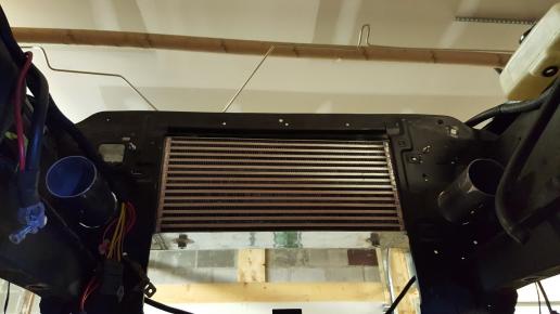

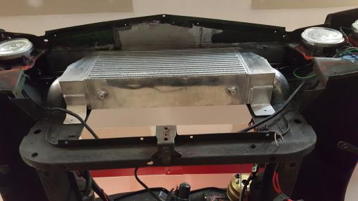

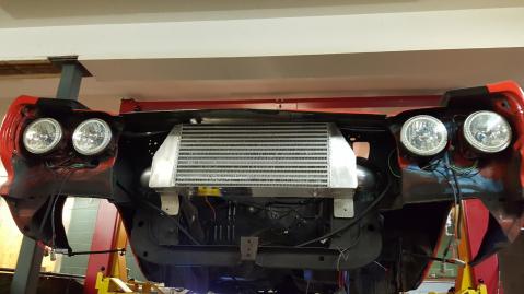

Here's a few pics of where the car is at today

Great progress! You going to black out the intercooler????
Now would be a good time to install the lower radiator support brace if your inclined. I used the US Car tool one.
Pretty sure we're going to make our own brace for the lower rad support and I agree now is the time.
The guy doing my work is a HUGE believer in blacking out. He had previously blacked out my wizard rad and even did the exhaust to all you see is the lines of the car. I'm 99% sure the intercooler will get blacked out as well even though it does look mighty fine in raw aluminum

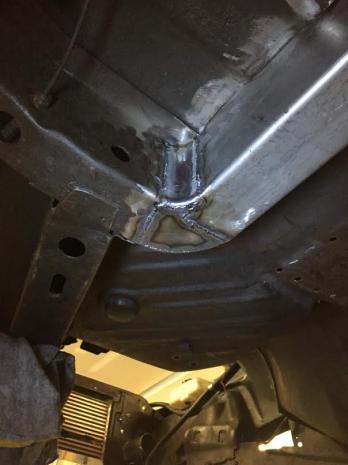

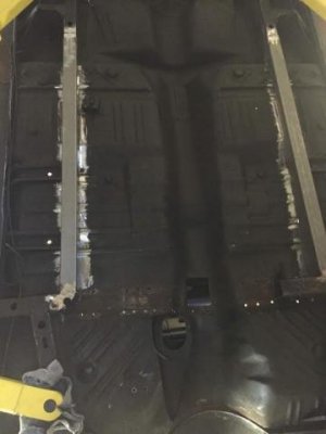

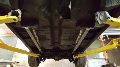

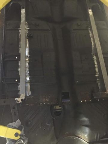

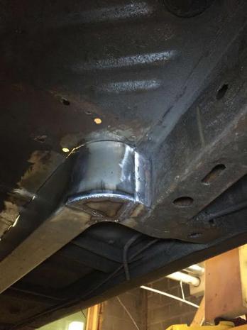

A few more pics of what was done with the chassis mods. The rear frame rails were extended straight into the rocker panels as the torsion bar cross member was deleted. Wanted to take this approach to give it a look like it would have been from factory if there was no T bar cross member.
The new trans cross member will be tubular so it looks like it belongs with the Magnum Force K frame.
In regards to stiffening around the rad support the plan is to add a round tube stiffener to also match the K frame from firewall top to the front of the frame rail to triangulate the whole front chassis (more strength in triangulation then just adding to the side)

Nice! I like the tie in. Are you going to tie the two together?
