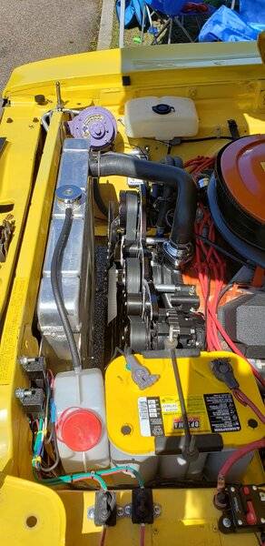

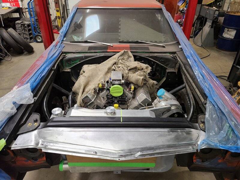

Great project and I've been following it.new rad fans
EDIT: I also have a high output (140 amp) alternator that is standard with the CVF Wraptor serpentine belt and accessories system.Aftermarket fans are too much load on the stock electrical systems. You need everything upgraded

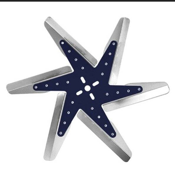

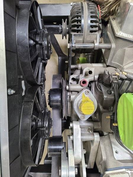

Understood, and again, your car is a great build. My mechanical fan isn't the factory clutch fan (that worked well) it's a "compact blade" style flex fan. The blades "look like" this:I'm agreed on SPAL fans only. I don't think I could squeeze a clutch fan in there if I tried with the massive 12 rib pulley for the belt driven hair dryer

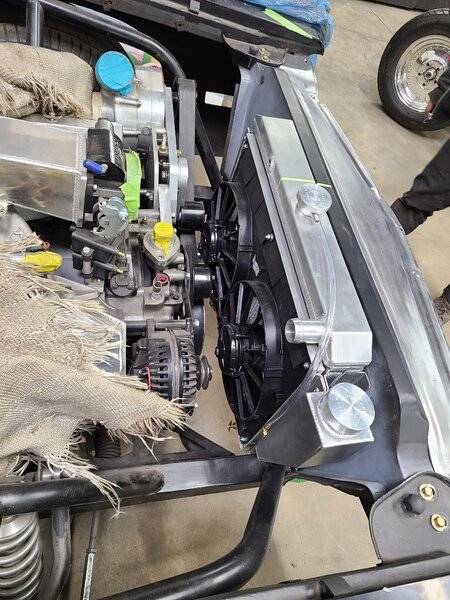

For the first few years my temperature would climb in stopped traffic, after switching to dual Spal's it's never climbed again. That was probably 4-5 years ago, not a bit of problems since. Come to think of it I think you suggested the Spal's?I'm agreed on SPAL fans only. I don't think I could squeeze a clutch fan in there if I tried with the massive 12 rib pulley for the belt driven hair dryer
