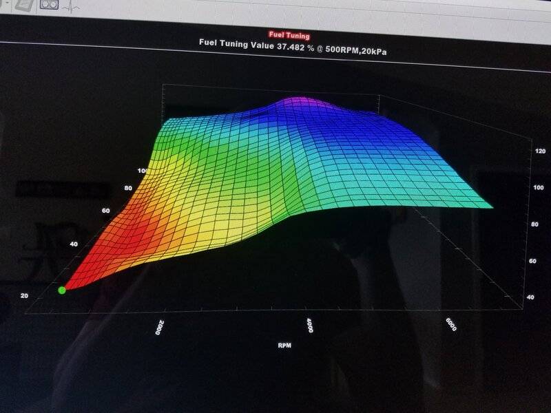

Here is a fuel graph after adding learn table and some smoothing.

I have not gotten as far as adding a user-generated learn table to my tune so I have a question - what is the 37.482% value at the top? If that's the amount of change from the original config, that seems like A LOT for any data point. If not, then do you know what that number signifies?
That is a VE number. That data point is for 500 rpm and 20 kpa which is a point on the map that is impossible to reach.
