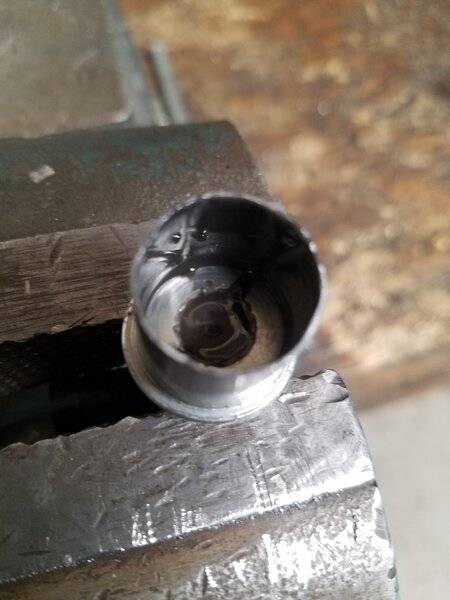

I gutted my pcv valve. I cut the end off, pulled the guts out, drilled a small hole (.090") in the valve I took out of it, and epoxied it inside the pcv housing. Should be cured tomorrow.

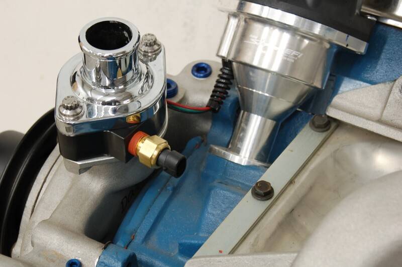

I'm assuming you have been working on this since Dec. and hopefully you have been successful. I'm in the middle of installing this same Holley EFI on my 440. What I'd like to ask you is where did you end up putting the temp. probe? I have Digital gauges and the only spot I can see for a mounting location already has the probe in it.

I have my efi probe in the WP, I also bought a coupler that goes in your radiator hose that has a port for my analog.

Thanks Mike, the water pump location is where I put the probe for the digital gauges. Finding a suitable location for both the EFI and digital is a real challenge. Can I ask where you got the coupler for the radiator hose?
Thanks for the info. How does that work out for you, do you get a correct reading for temps and the EFI?

They are pretty close, the Terminator reads 182ish and my Autometer gauge will read 5-7° less.
It's just a theory but I'm thinking the there may be some conduction heat from the block into the pump, where as the coupler is isolated from everything but the water.

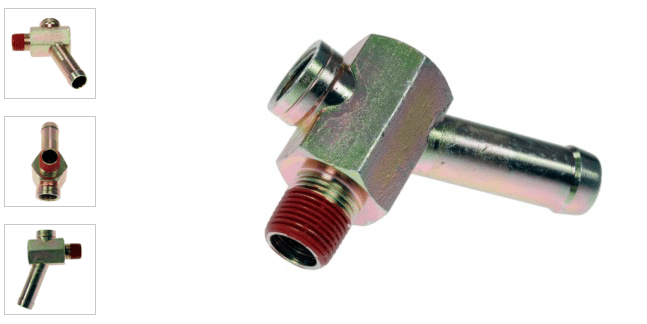

A heater hose Tee fitting might be your best option...
https://www.napaonline.com/en/p/NDP...6478877959&adgroup_id=79272987338&adtype=pla&
Thing is who ever wrote the page didn't give usable specs so I have no idea what the thread size is.... I've seen various sizes of similar fittings in the past but who knows if they are still available...
Yah I see that, 17.4 mm, thanks for the link even so. This may just help if it can be adapted, thanks for the help.
