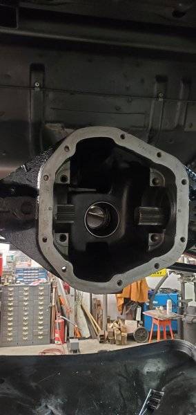

Last time out I could hear a click, click, click coasting into the staging lanes. This is not the first time. Pulled the cover. Zero back lash. Popped it all apart. Fluid looked good. Spool has zero runout. Bearings look good. Still had preload. But ah, the pro gear pinion. Not so good. All cleaned up. Going back to 4.10 from the 4.30. Standard Motive gear this time. Previously it has lasted the longest (425 passes). Also opening up the back lash to .012". We'll see how it works.

This not the first time. It lost a entire tooth on a 9.10 pass (pics below). Pinion ws cracked in the same area. It also bent some pinion teeth on another set. I'm going to try opening the backlash up to .012" which has been recomended bymore than a few peoplle.

Doug why increase backlash? I've no expertise so just my thought. Increasing the backlash won't it move the pattern toward top of tooth, putting more force on base of tooth? Increasing backlash would seem to allow under the right conditions the pinion to slap the ring harder because of the extra backlash?
Set me straight! Thanks
According to what I've been able to decipher. The teeth flex. It allows them room to flex. Many along inc;uding Strange tech suggested more back lash. Pattern "precision" seems to be based on correct pinion depth more than B/L. In this case gear noise is not an issue.

Good catch! I'd get away from a pro-gear (if that's what you're using) and go to a more hardened street gear. I had the same issue some years ago.

Is the housing ok? How's the angle from pinion to ring?
I believe the housing is good. Pattern always comes in nice. Are the tubes still dead staight? They were when it was built. Drives good and goes dead straight on long wheelies so my bet is it's close.
