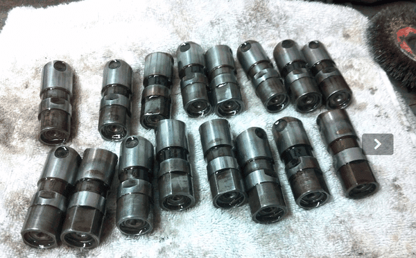

I got a lifter problem...I think?
All cleaned up :)
Cool. Advice. Lube them on assembly, of course....BUT if that was my engine, I would change the oil in it.....again......and dump in a can of sea foam or marvels mystery oil.

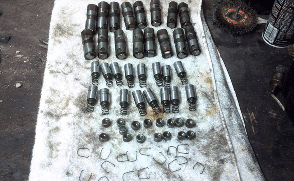

all assembled :)
Yeah, i dunked them in fresh motor oil before i assembled them..I just stuck one of the pushrods into my drill press, then wadded up a rag under it, then used the press to compress the lifter, then just stuck the closed part of the c-clip in there-n-let it back up...then pushed the open ends of the clips into the channel to lock it in :)
The engine is gonna get a helluva cleaning again before i put them back in...I'm gonna drain the oil, then dumped a few gallons of kerosene right down the engine valley, then a few quarts of cheap oil right back through it, then close up the engine, and some fresh oil/filter/MMO...That worked well when i cleaned it the first time with the damn squirrel nut incident lol...I'm sure it just needs it again...I still occasionally seen some small carbon particles on the oil stick before this happened...
Cool. So how well did the plungers compress? Nice and smooth I take it? I think you just fixed the hell out of your problem.
