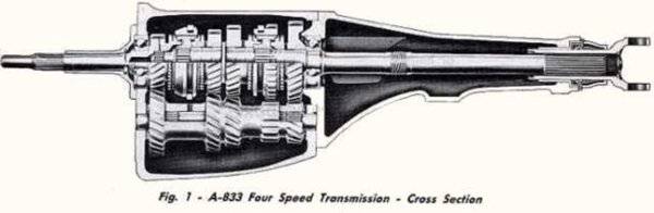

If that's the case, we aren't talking about many possibilities here, especially possibilities that sound like a gearing issue:
There's only the main output bearing, the speedometer gear drive, the mounted shifter and the tailshaft bushing & seal in the extension housing.
To me, that only leaves the bearing and the speedo gear setup as possibilities?

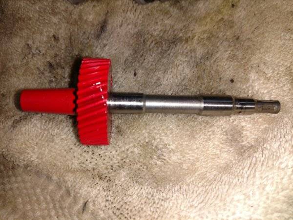

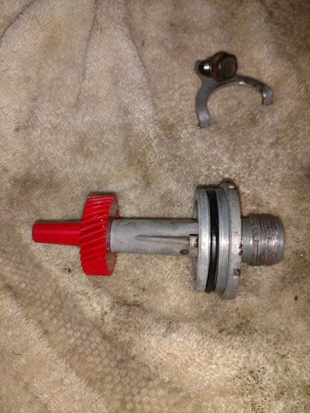

It looks new, like it ought to since it is.
