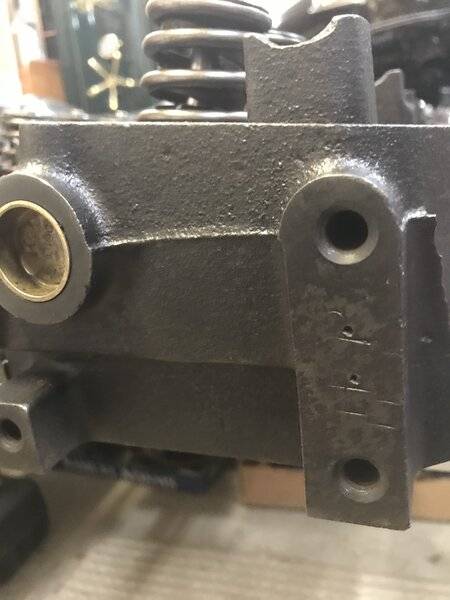

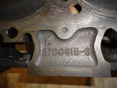

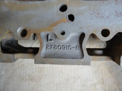

The larger valve 915s had the throat opened up from the factory to accept the 1.74 Exhaust, that's the main difference. Small valve castings were cast with a "K" and large valves with an "L". 915s were also offered over the counter. I'm not sure how long they were offered. I put an NOS pair on my motor with stainless valves and a little porting. The guy I got them from was a big racer in the early 70s. The over the counter heads had no letter cast into them.
275889-34ad137ee6930b95a84c60b9b64312fe.jpg 275890-8d72b2c4250183a8df70c35f3416c538.jpg DSC00152.JPG

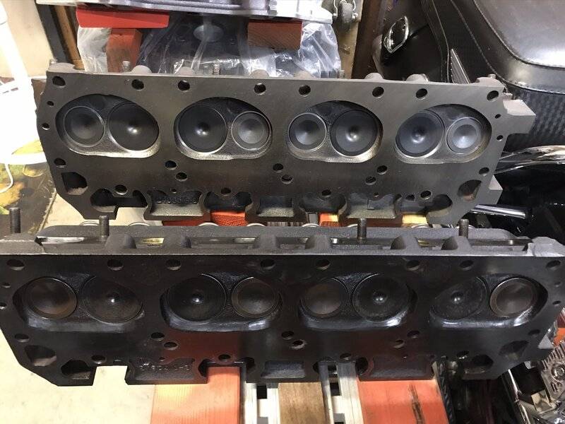

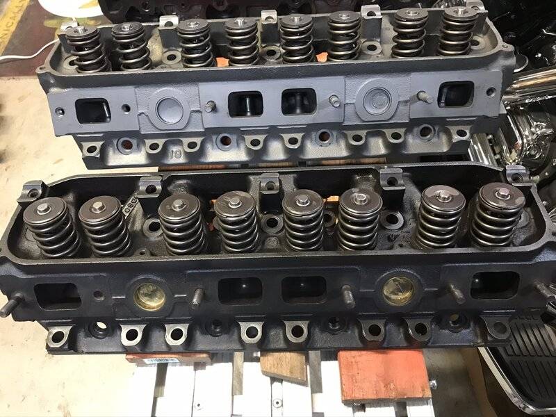

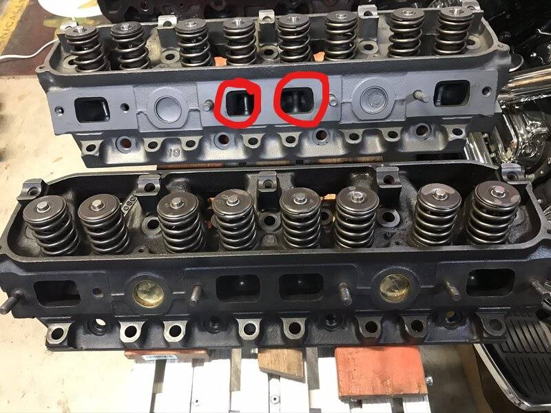

Here is a 915 HP head with the “L” casting and 1.74 exhaust valve
In the back on the 2nd photo is the 516 head with smaller 1.60 exhaust valve.
Also notice the valve spring size of the 915’s and exhaust port difference
Both closed chamber heads.
The heads above had had a lot of work on the exhaust ports. You can see straight in at the entire exhaust valve. They don’t look anything like that in stock form.

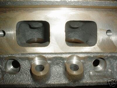

I have ported all the heads from the 'lowly' 516 to the 452's and the awesome Max-Wedge.
440/383 Intake ports are all very similar up to 1970, but the problem lies in the exhaust area's.
The worst ex-port is the 516 and the best is well, all the others...
None have the flow capabilities of the Max wedge, but are good street heads.

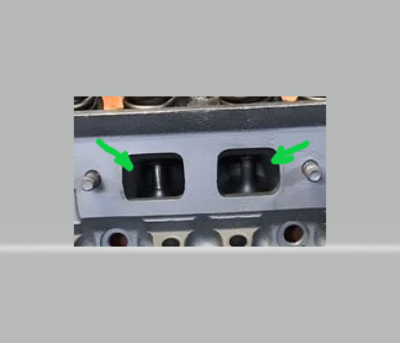

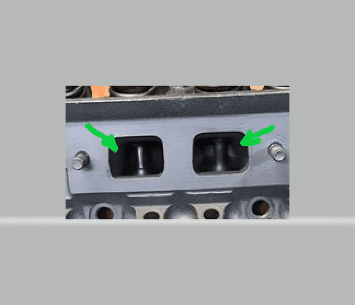

If you look inside the exhaust-ports there is a casting area that projects into the flow path.
This is most noticeable with the 516 and was corrected in the 915 casting onwards.
Yes a 1.74 is very doable in the 516, but a 915 will take a 1.81 comfortably...

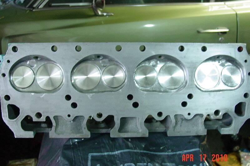

Hard to find good pics of Max Wedge heads?
Anyways they have nice ex ports as you would imagine...:thumbsup:
No lumpy bits in the flow-path...:moparsmiley:
